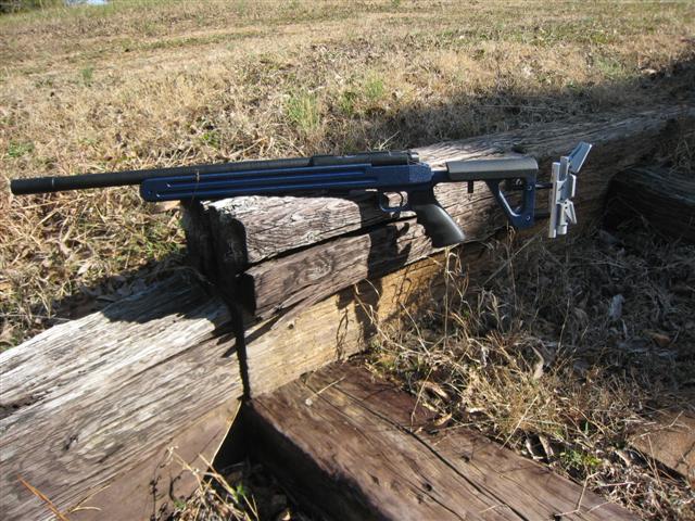

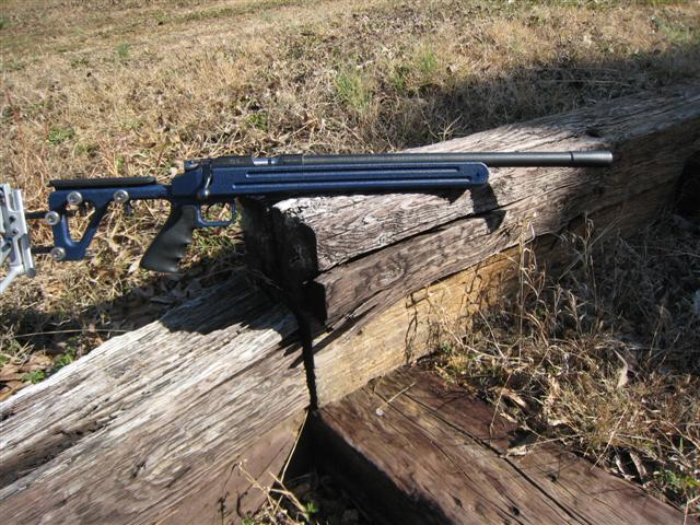

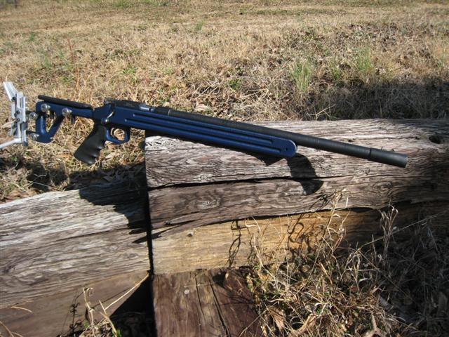

GCSInc
Posts: 246
Same Stock
Post by GCSInc »
This is the same basic stock, but this one has a CZ 452 in it.
CZ 452 in a PDC Custom Stock
