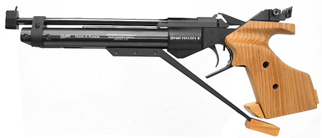

To test if you need to replace the bolt seals, just cover the bolt area with a light tissue paper, cock and shoot the pistol.
If you see that a puff of air has moved the tissue, then you need to replace the seal(s). I never had any problems with my seals, just leave the bolt unlatched when you finish using the pistol and use a slight dab of silicone grease when you see them dry.
unlatched bolt IZH46M pistol.jpg (22.9 KiB) Viewed 1438 times

Thanks for the reply. I tried as you suggested and there was no movement of the paper at all. It still shoots R10's @ 495 fps average, but since the seal is partially covering the port hole and looks like it's falling apart, I thought I could get a little more fps out of it, plus I'd rather replace the seal before it fails in the middle of a match or something.
