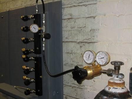

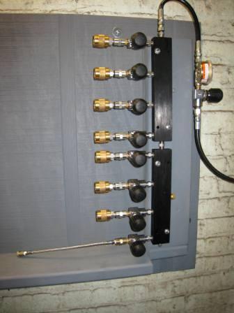

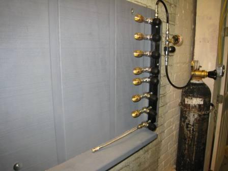

Oxygen and any petroleum based product can spontaneously combust. You might know this as an explosion, or simply a blinding flash of light, but in any case, it's a real bad idea. Compressed breathable air is what your pcp gun is designed to run on. Nitrogen is the way to go if you're looking for industrial quantities of bottled gas. Here are some photos of the Nitrogen Fill Station we have at The Ole Mill Range in Griffin GA. You could also go with a compressor, but that's usually expensive unless you're filling a lot of cylinders or have a very large club or range.
