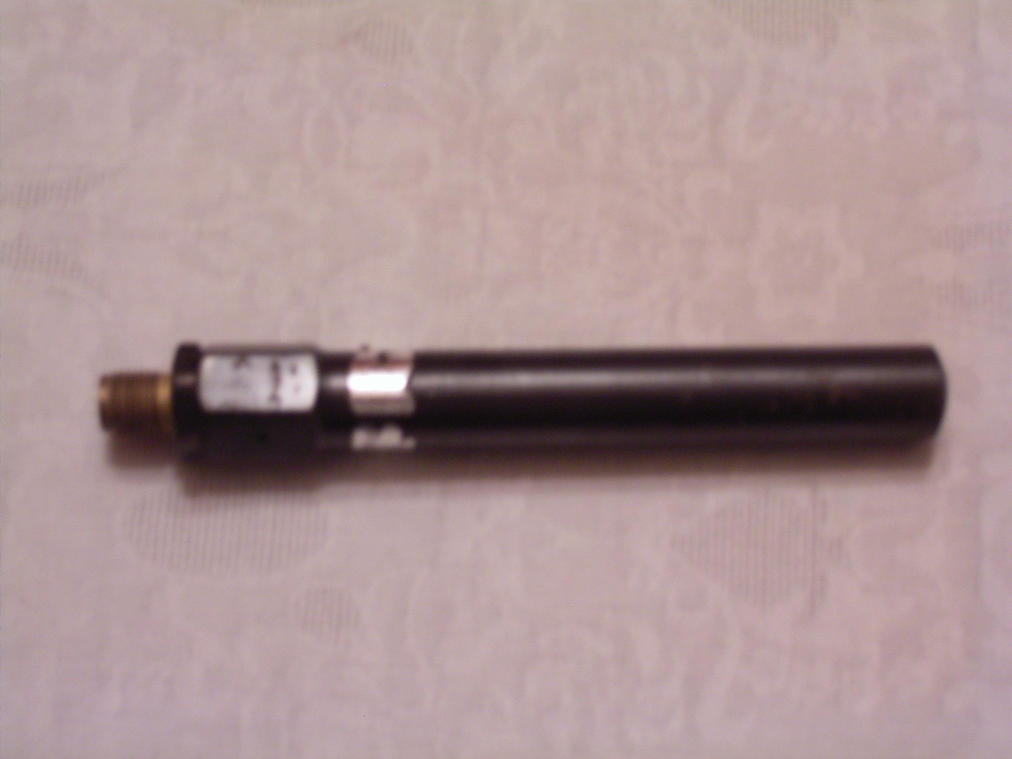

A significant benefit offered by refillable CO2 is a consistent pressure right up until the CO2 is nearly gone. The CO2 remains liquid until released from pressure, at which point it violently converts back into a gas. The idea of having nearly identical propellant pressure for all shots in a match is intriguing. As I shoot my LP-10, every shot I take is sent down-range by a slightly different PSI (or BAR) value. Each shot, no biggie. From shot #1 to shot #60, it's a significant difference.
Up until this year, a CO2-based Steyr LP-1 held the world record set in 1989. 593. Just this year, that record was finally broken by a compressed air Steyr LP-10. 594.
The only downside is that CO2-based arms are indeed sensitive to ambient temperature. Too cold, the CO2 doesn't vaporize quickly enough, too hot, the CO2 vaporizes too soon. Refilling also requires a little more attention since you refill by weight. I understand that ideally, one should place a CO2 cylinder in the freezer before refilling --to get keep as much CO2 in liquid form as it is pushed into the cylinder.

Another big benefit for some of course is that they find it much easier to get CO2 than have scuba tanks refilled. We are lucky here in the UK in that most people will be within relatively easy driving range of a dive shop.Oz wrote:A significant benefit offered by refillable CO2 is a consistent pressure right up until the CO2 is nearly gone.

No, CO2 and PCP are definitely *not* "interchangeable" in any sense of the word. The two systems are completely different. The entire mechanism of each type of pistol differ substantively.
The systems are different. Each has its own advantages and disadvantages as thoroughly discussed in some fairly recent threads. CO2 is the "old" systems and PCP is the "new" technology. Many matches and clubs no longer support CO2 systems at all.
Either system will shoot as many tens as you are capable of. It's a matter of tradeoffs between cost and convenience.

"Serious" PCP guns for match competition have regulators and manometers. This means the working pressure of the mechanism is constant, and you can check how much air is left in the cylinder.
CO2 guns don't need these refinements.
With CO2 you need special gaskets/O-rings, so a PCP gun is not CO2 compatible. To fill a CO2 gun with liquid gas, you need to cool down the cylinder (appr. 5 inutes in the freezer) before filling.
Because the CO2 is stored as liquid, the shot capacity is pretty high despite lower pressure than PCP.

Ah, I see, liquid CO2, same as the disposable canisters. I was imagining gaseous CO2 - Such a system would be essentially the same as PCP, obviously a liquid CO2 system would not be! Not come across them before.
As David says, I know a half dozen dive shops and gun shops where I could get a refill of breathing quality air into a buddy bottle or direct to a cylinder.
But refills of CO2? No idea. I suppose one could approach an electronic engineering or chemistry mate who might be able to get it through the lab or clean room supply, but commercially? No idea.

CO2 is easily obtainable from welding supply shops, fire extinguisher dealers, and beer/soda distributors. It may be purchased for home use in 5, 10, and 20 pound (contents) cylinders.
I was surprised to learn that much of the CO2 is captured from brewery fermentation tanks and would otherwise be vented to the atmosphere.
