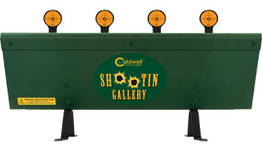

Moving target
Post by darticus »
I have a moving target set up and would like to back it up with a trap maybe I could use 2 or 3 outers traps behind it as its 3 feet long. With the concrete wall behind that. See pic of moving target. Feedback wanted! Thanks Ron

uncle_joe
Joined: Thu Jun 11, 2009 9:24 am
Location: wi
bullet stop
Post by uncle_joe »
Conveyer belts work great. Factories and quarrys usually pay to get rid of them. One layer will stop a 22. Two will stop a 45 (depending of course on fow thick they are).
darticus
Posts: 318
Joined: Sat Sep 03, 2005 11:01 am
Location: SPARTA NEW JERSEY
BELT
Post by darticus »
That is some great info! I will keep that in mind. Thanks Ron
