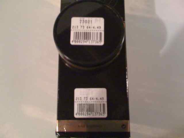

The sizes were on the case, the sleeve, and the individual tins. This is the same as what I saw at the RWS test range in germany too. Sizes are never printed on the tin itself, it would required different tins, but always on the sticker that contains the lot # on the bottom of the tin, with bar codes.
Heres a photo (not a great photo) don't feel like breaking out the camera).

The labels on the back of my R-10 tins only have the lot number on them. I don't have a sleeve to go with the tins. I wonder if they are 4.50, as Fred said.

All tins of RWS R-10 premium line pellets for air rifle will have printed on the lid:
Kal. 4.5 mm
Cal. .177
0,53 g
8,2 gr
The same line for air pistols will read:
0,45 g
7.0 gr
The batch size will or should be printed on a sticker on the underside of the tin where it will say either 4.8, 4.9, 5.0 or 5.1 along with a batch code number. This corresponds to the head diameter not skirt.

An amendment to my last post concerning the batch sizes.
Batch sizes on the under side of the tin will read either:
4.48, 4,49, 4,50, 4,51
