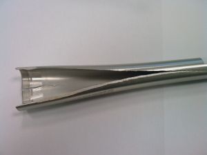

True, however it was posted again this morning in a newsletter from our national shooting organization (Deutscher Schuetzenbund) with the added information: Anschuetz received 60% of the cylinders in question. This means that some 2000 of these cylinders have not been returned. Meanwhile 4 cases of personal injuries have been reported. Here is a photo of a blown-up cylinder:

Our rifle program had 3 or 4 cyl. on the list. One of them had 4 cracks at the gauge end that had gapped open . This cyl. was ready to let go. the other 3 were ok. If you have any of the cyl. on the list, Get them exchanged before something tragic happens. Also, a dive shop told me that it is important to fill any pressure vessel slowly as the heat that is generated can weaken the cyl. from the inside out.He stated that heat and moisture are the biggest enemies of pressure vessels. I have seen many people crank the valve wide open on a scuba tank to fill their cyl. and have the cyl. very hot to the touch. I know that the recall is from weak materials, but a heated cyl. may shorten the life of a good cyl.
