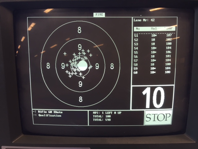

While I'm waiting for my starik tube to turn up I thought I'd experiment with adding wheel weights to my tube to bring it up to the same 220g total weight that Guy uses. I popped down to Bisley last night for a quick 60 shot match and the results............598/624.7 44x!!!! Absolutely smashed my old pb of 592 (and bisley pb of 585). So there would appear to be something to gain with weight at the end of the barrel!
The two nine's were the first shot after putting the rifle down for a break half way, and the second a 9.9 as the light levels fell. Looking forward to receiving guys tuner now.

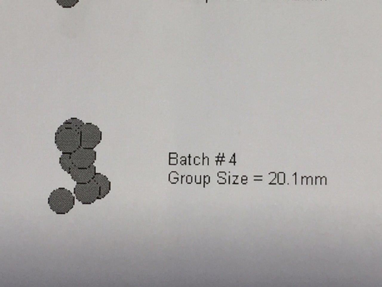

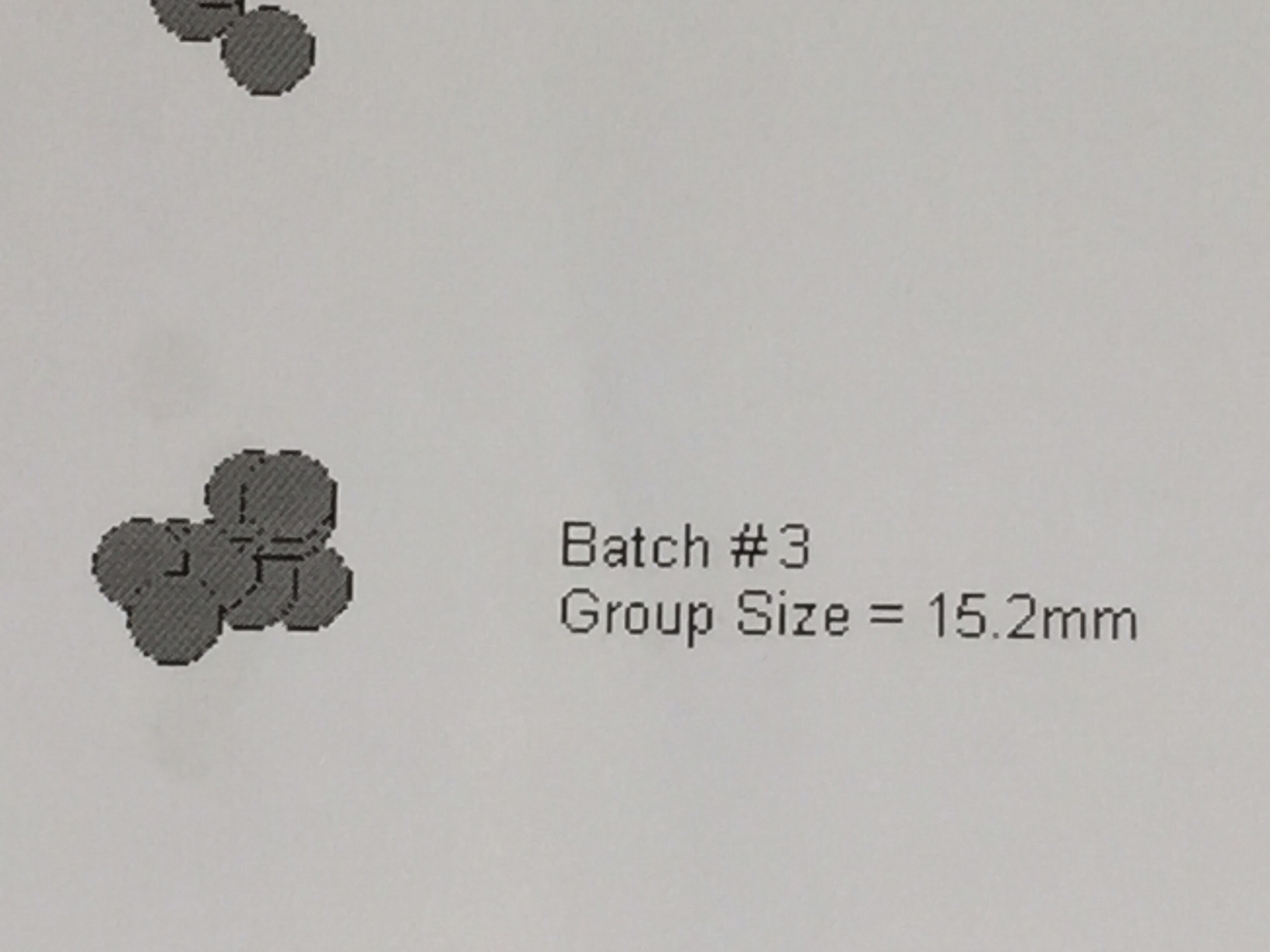

Just as an update, if anyone's interested.
Guy's tube has arrived and I've finally had chance to test it in a vice at Bisley.
I have two photos of the group size for 10 shots of Midas+ shot from a vice at 50m, without and with the turner.
So obviously there's a significant improvement with the tuner, this group was probably the best group size and the weight wasn't moved from the 0 position. I then wasted about 500 rds testing at different positions and things only really got worse, I didn't seem to find a few sweet spots that other people report. But I'll revisit again later, if I'm going to be competitive next year I'll need tighter groups than that!
Another point is that this same batch of Midas has tested better in the past, however that was when the barrel was new with less than a 1000rds through it and now it's upto about 4000 so has probably changed as its bedded in and isn't really 'matched' anymore.
Still work in progress but it would initially appear a worthwhile purchase.

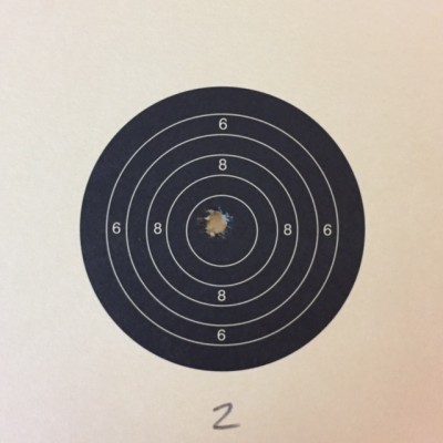

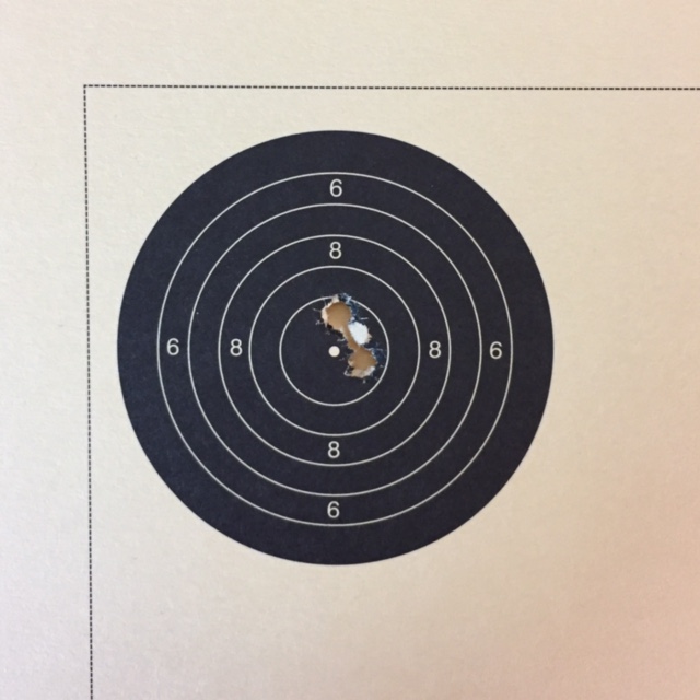

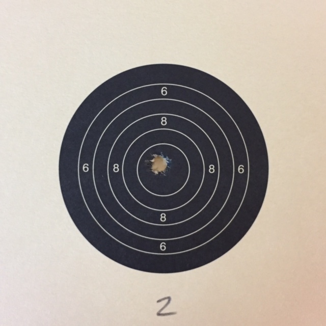

Update #2
So visited the club last night, 25 yards indoors this time. Shot from a rest in the prone position. In order to get a spread of speed I used RWS Special match and RWS R100 to give a 15m/s or 49 f/s difference in speed.
First target with tuner weight wound all the way in, one round of each, the R100 was the high shot.
Started winding out the weight, and at two revolutions out these were the results:
I carried on testing and the group opened up again. I didn't keep testing to see if there were other nodes as I was more than happy with these results (and I was cold and hungry). I did revisit two turns out to confirm the results and shot three practically indentical diagrams.
I know this was only 25 yards and will need retesting at 50m (when the weather warms up) but to be honest I shocked that two rds, one above the speed of sound and one below, can be made to hit the target in the same place! Very pleased with the results, thanks Guy.
