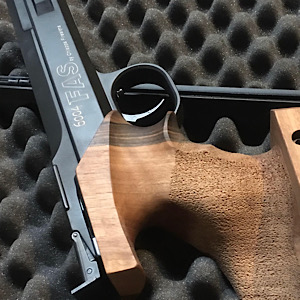

Finally, ending my work...at least in regard of the FAS 6004, I achieved 414 fps Avg with a 5 FPS variation on Finale ..
Many might say what a waste of time, especially if comparing to the modern PCP pistol running low 500s but trust me this was huge for me, coming from 327 fps. I honestly never thought i would make 380 fps at the outset of the work and it does mean a reasonable performance from a self contained gun, with no bottles or power curves to worry about.
It means clean cut cards and even manages to put down knockdowns at 15 mtrs and that is about as accurate as i can shoot a pistol off hand.
It means that this best looking of pistols can now marginally out power stock HW40/75 and P17 variants.
However, after finally reaming the transfer port to pick up 10fps, I realise there is no more to be had in this gun and I move onto my next project..
- BCBFF200-4AF7-49C3-BCD3-1D4854B18576.jpeg (43.47 KiB) Viewed 11077 times
