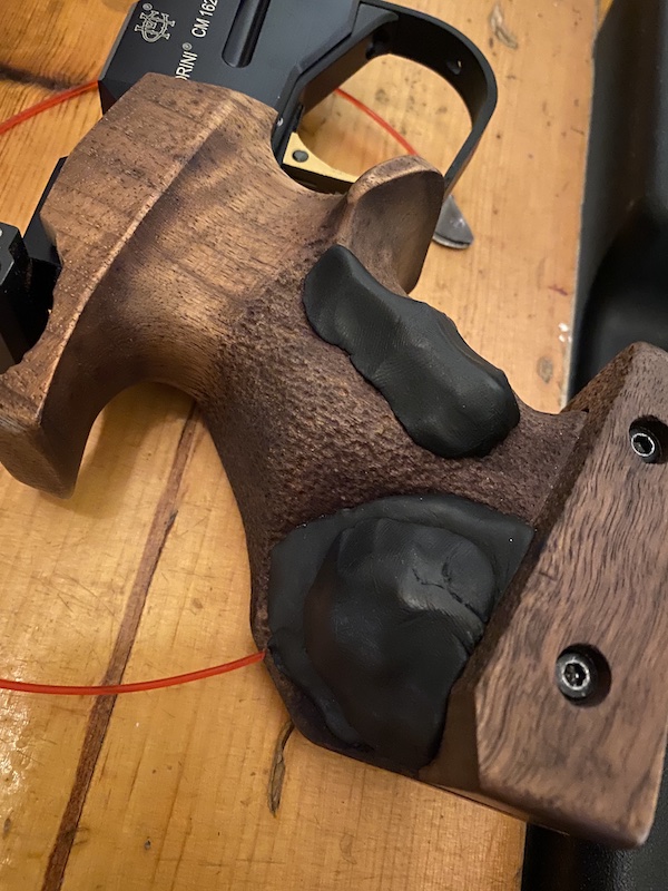

atomicgale
Posts: 864
Re: Get a grip, man!
Post by atomicgale »
Voila'! A veritable Michelangelo.
After multiple putty/grind/sand; hopefully this is last iteration prior to final spring CMP match.
