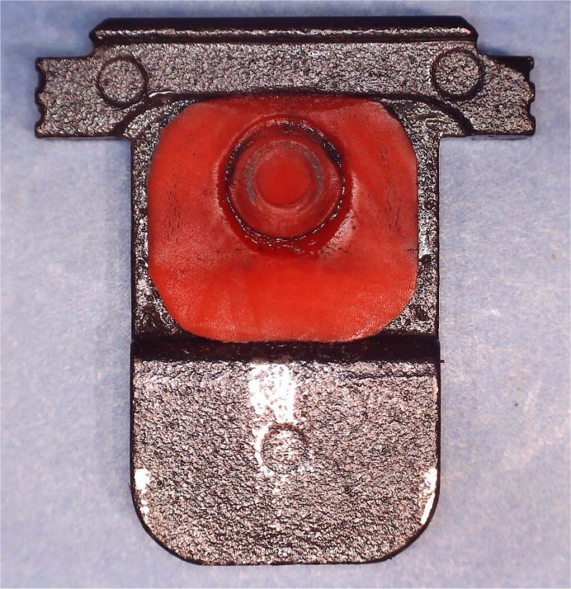

It's interesting that you mention the buffer. I'll have to take a photo the next time I have it apart. The bulk of the damage is a very tidy circular cut where the buffer has tried to extrude itself into the hole in the back of the bolt.

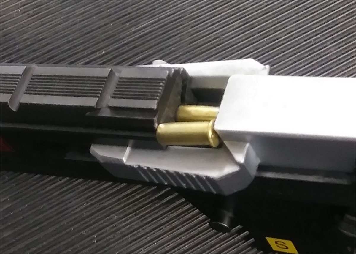

I fired another 80 rounds today with the heavy recoils spring. Round #53 trapped the case lengthwise between the bolt & the breech:
I had cleaned it 133 rounds before the jam, when I changed the spring. I've seen this type of jam a few times since I re-ground the extractor, and I have to wonder if the change in extractor tip angle is tossing them up more. I also seem to be getting more rounds visibly going straight up, or worse, bouncing off my head. What I don't know is if these jams are from the case just popping up several mm & getting caught, or if they are leaving the pistol & falling back down into the action. I've had at leas two instances where the case is trapped lengthwise but backwards, which is hard to do if the case never left the breech area.
In any event, I don't think the jam is related to the recoil spring change, and the other types of jams I was getting before that change have gone away (so far). I will continue testing...

As promised a while ago, here is a picture of my buffer:
The large circle is from the hole in the bolt, and the smaller circle is from the hole in the recoil spring guide tube. Aside from the circular marks, it's not in that bad shape. I've replaced several that had major chunks broken out.
It's definitely a rubbery material, and not one of the harder plastic ones from LGI. I know some people have had issues with the Benelli buffers, but I wonder if they improved them over time. This might be a newer one.
