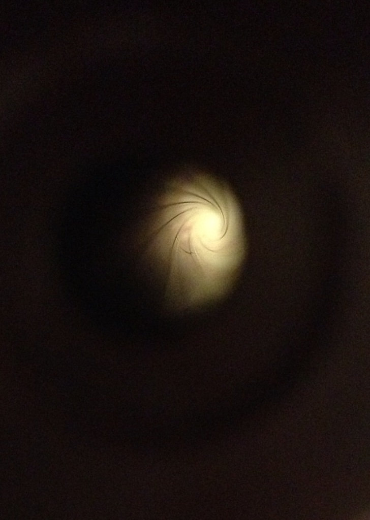

Sorry to revive an oldish thread however I've had exactly the same experience last week! I had a batch testing appointment at Bisley with RWS and the results were terrible too. The best group size measured 15.5mm where other rifles were at about 12.5mm with the same ammo. My tenex control was 26.4mm!
I popped over to Robert Nibbs as he's not too far and he again found lead fouling in the barrel and recommended the same course of action, two hours with VFG blue paste (really nice guy and very helpful). So last night I pulled the workmate into the lounge and spent two hours polishing the barrel whilst watching the telly. By the end the barrel was warm to the touch!
I haven't had chance to get to the range to try the results however I'm not expecting the same results as Nigel as the polishing has removed the lead so effectively that I can now see the pitting that it was filling! It would appear that although my 29 year old 1813 has had very little use, it also has had very little cleaning too.
So my question is just how detriment to performance is slight pitting in the barrel? Thanks Bryan
