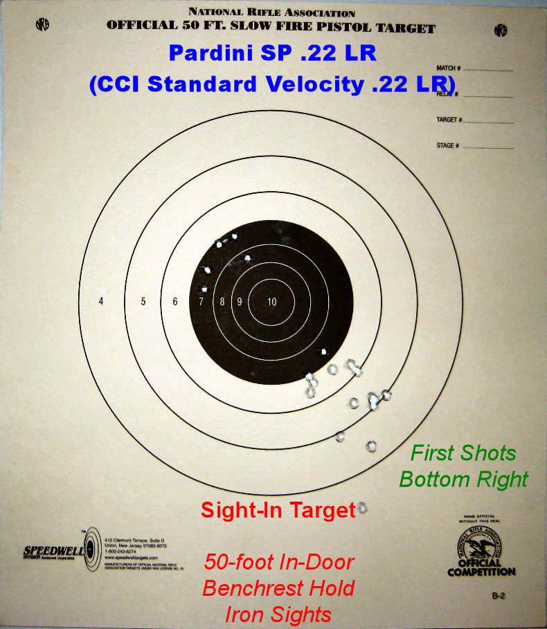

I just got a call today that the brand new Pardini SP is already at my range so I'm going to go see it this week myself and I'll post new pictures of it here again.
Targets - Sight-In and Practice

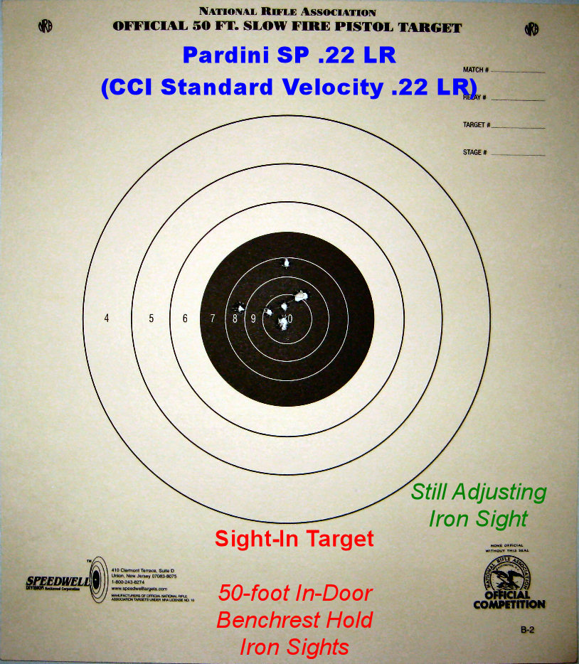

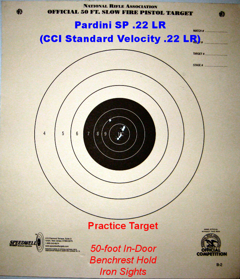

You reminded me of the targets that I kept from sight-in in this gun with my friend. He did all the sighting in since he has a very good eye and the steadiest hands of anyone that I've seen shooting before. I'm sure that in time you'll see him competing in the Champion's Circle for sure.
We only had half-an-hour to spend with this pistol so we did a quick job on the sight-in and also to test it out for reliability and feeding with the CCI Standard Velocity ammo at our in-door range at 50-foot distance. Most of the shots are pretty rushed since we just wanted to see where the gun prints after adjusting the sight so we weren't going for accuracy, but more for speed and reliability. So don't base all your judgment on these targets about the accuracy of the gun but just get a sense of how it performs.
Target - Sight-In First
Target - Sight-In Adjustment

Target - Practice Benchrest

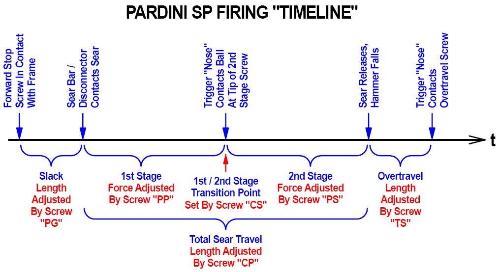

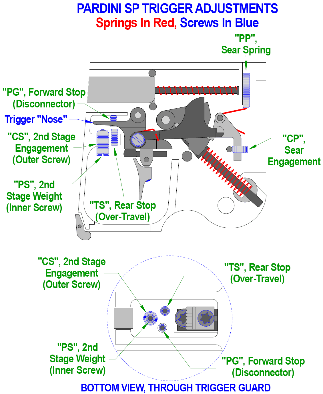

Trigger Adjustment
The trigger came unadjusted from the factory. It had a very long 3-4mm movement in the first stage (take-up), a nice and crisp break requiring only medium pressure for the second stage, but a long 1mm over-travel. This unadjusted trigger was quite sub-par from such a special target pistol and I immediately proceeded to adjust it.
The first step that I did was to move the trigger forward into the trigger guard on the trigger rail to move the trigger as far forward as possible, positioning the trigger in the middle of the guard and giving me additional length for the distance of my longer trigger finger.
Afterward, I used the CP (Sear Engagement, First Stage Length) screw to reduce and remove the first stage travel length and slack on the trigger. Then I used the TS (Rear Stop, Over-travel) screw to remove any noticeable over-travel of the trigger after the break. Then I slightly adjusted the PG (Forward Stop, Disconnector) screw to allow just enough motion for the trigger to reset and the sear to engage the hammer again after firing. I noticed that if this last screw is adjusted to remove all second stage motion of the trigger that the trigger will break correctly but it won't have enough motion forward to reset and the sear won't engage the hammer again without moving this screw a little back.
Finally, I moved the CS (Second Stage Engagement, Outer Screw) up to meet the trigger lever so that it just contacts the ball-detent of the PS (Second Stage Weight, Inner Screw) allowing me to very slightly lower the resistance of the second stage trigger break.
I did not adjust the PP (Sear Spring Weight) screw yet since I did not want to reduce the trigger pull weight before trying the pistol. I most likely will adjust this screw out to reduce the trigger pull since it is just a bit to heavy right now for my liking

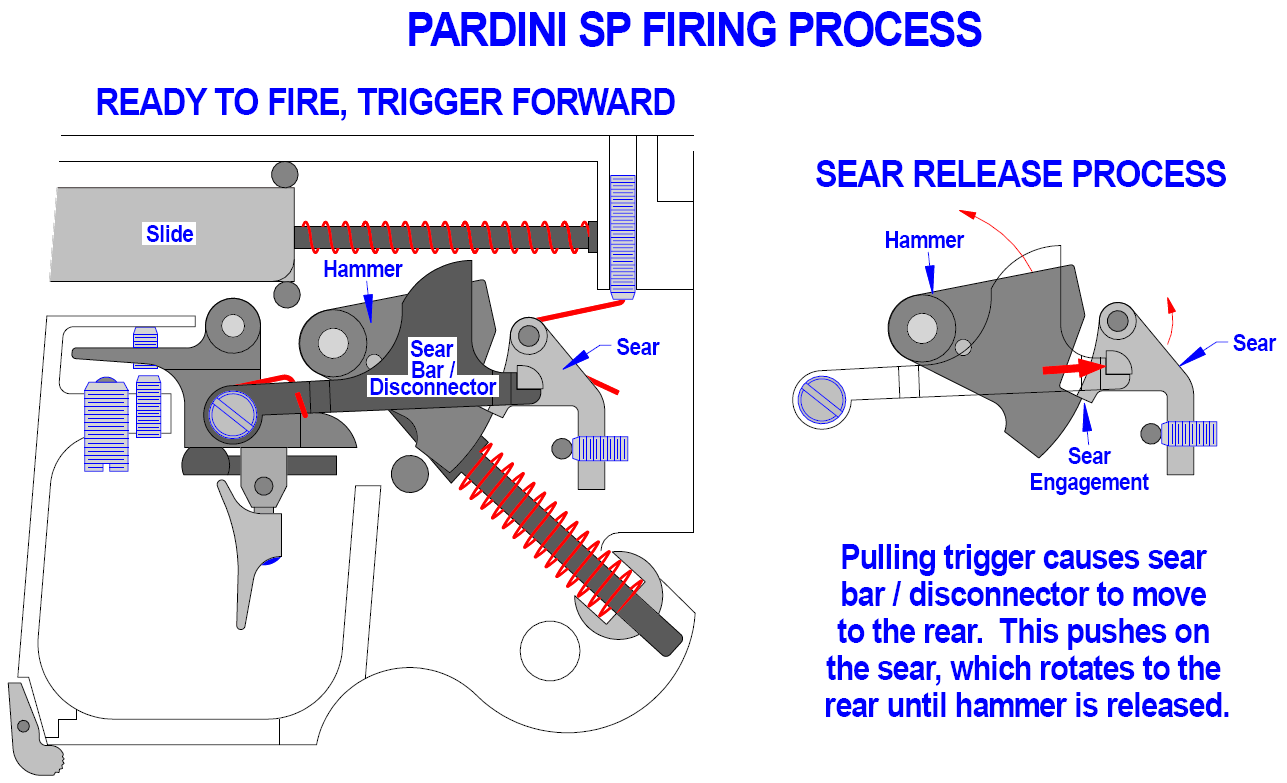

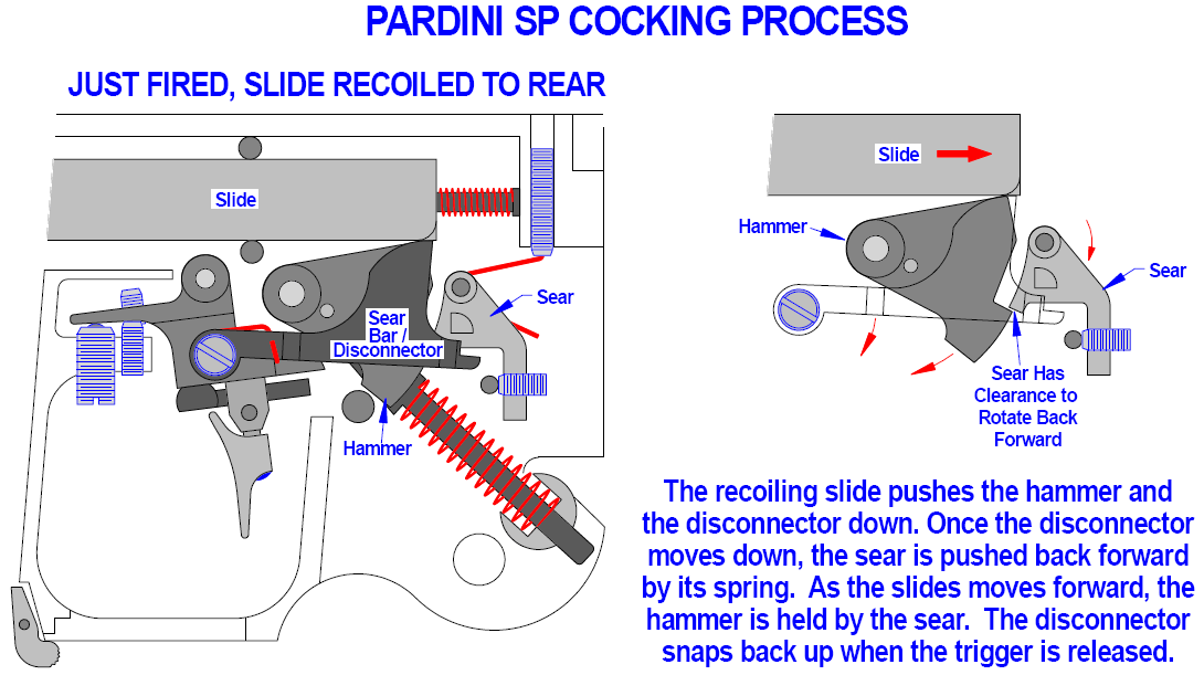

Adjustment Diagrams
*I found these adjustment diagrams posted on another thread and they were created by another user of this pistol but I am reposting them here as a reference to the trigger adjustments that I made.

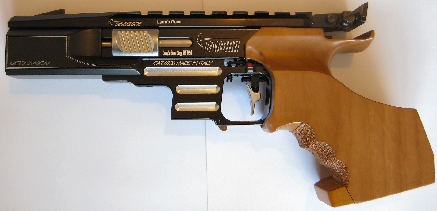

Pardini SP New .22 LR - Pictures
Post by JakFrost »

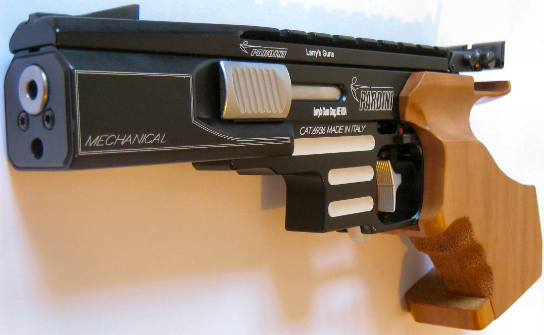

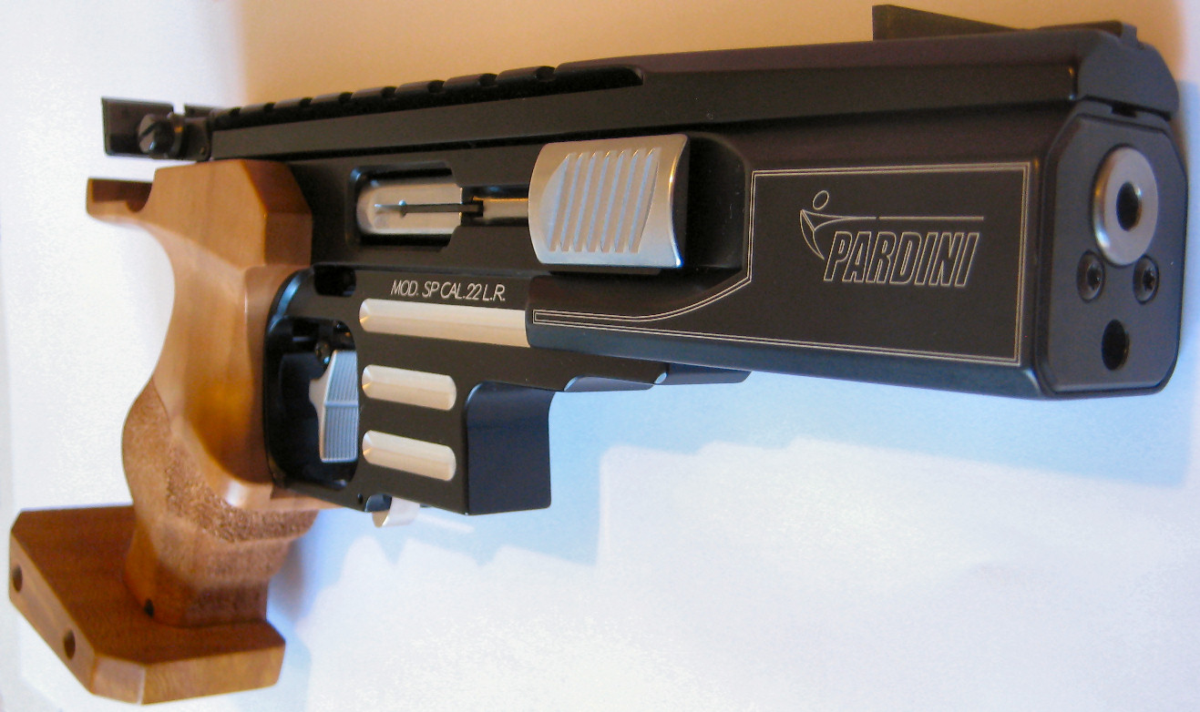

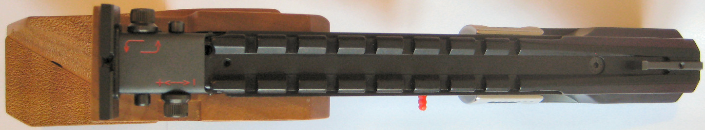

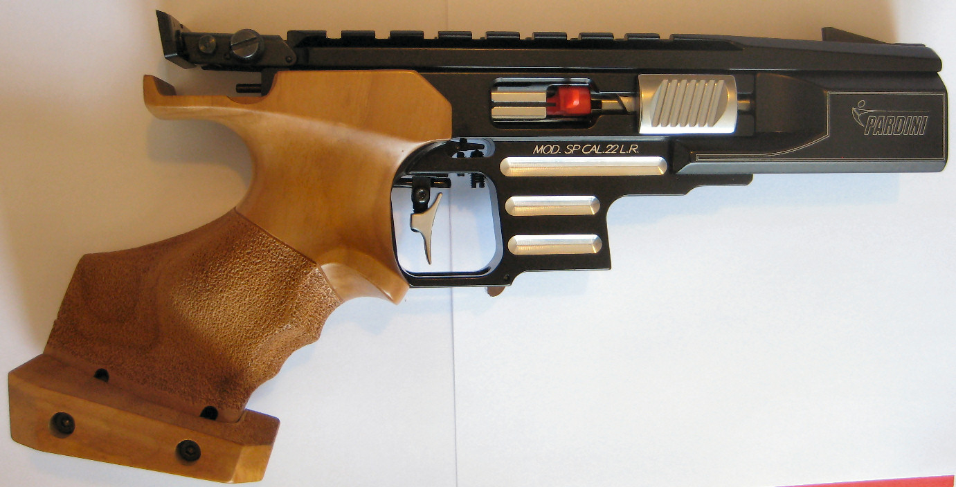

Here are some pictures that I took of this pistol today.
The lighting on some of the pictures is not very good so I might have to reshoot them again since some of the pictures are underexposed and lack detail in the darker areas.
Pardini SP New - Front Left
Pardini SP New - Front Right
Pardini SP New - Left
Pardini SP New - Right
Pardini SP New - Top

Beautiful piece of craftsmanship. Looks like the Ducati/Ferrari/Masserati/Bugatti of .22 target pistols.

That’s a might hansom pistol. I received my used (JakFrost) Pardini from Larry’s today. Also a magnificent piece of work. Got to parade it around work as we are a gun friendly shop. I’m about to leave work and head to the range. The only disappointment so far is that I didn’t get the scope mount I ordered. It is in a back order status. I was going to try it out without the scope first anyway but these old eyes don’t see very well and our indoor range isn’t lit very well. I over compensated in grip size and got a large which is a little too small. Going to have to see if Larry will trade me. He tried to get me to go bigger at the time but I underestimated my fat hand with short fingers and went for the large size. I worried too much about reaching the trigger which was always a problem with my Victor. Well off to the range—More later.
