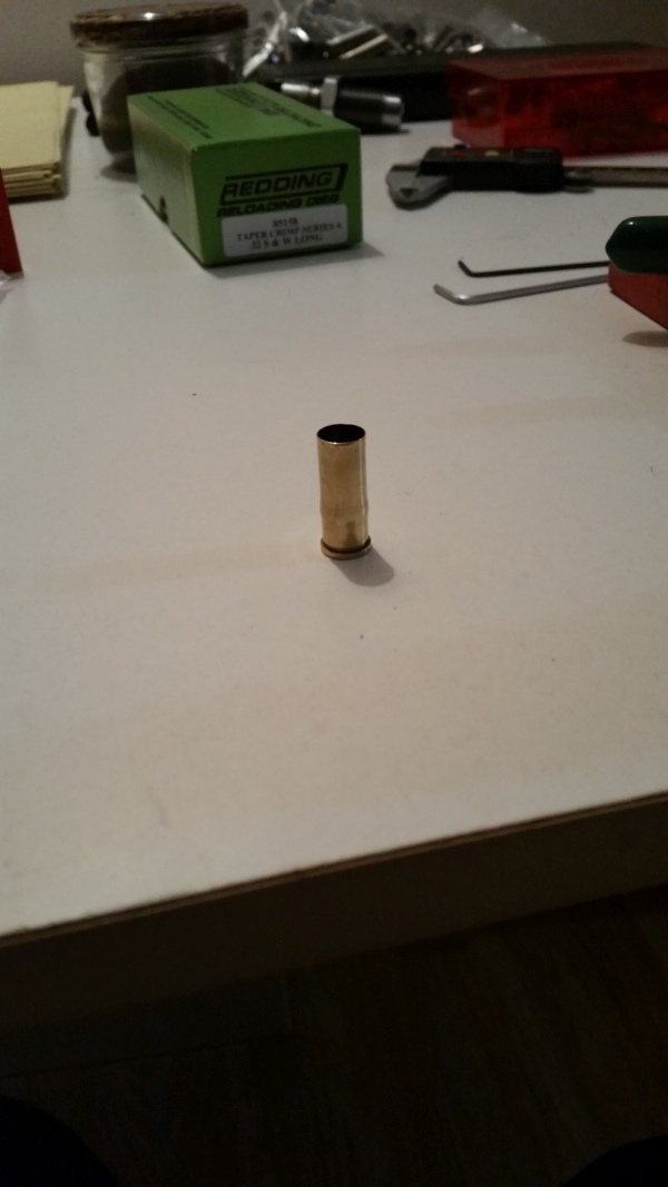

Gentlemen,
somewhere here on this forum I read about expander plug. I let make one, with diameter .313 and lenth of the plug is set to calibrate inside of the case to same distance where bullet goes. I am using .314 HN wadcutters. When I did expanding with bell ,the case is like on included picture. The plug cut small amount of brass inside and make bulge on the case.
Have you any experience with this?
Thanks.
Jakub.
