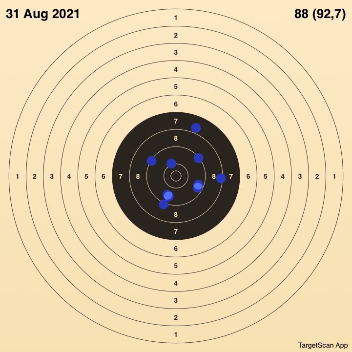

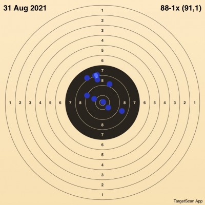

nmondal
Posts: 251
One by one shot - 11 shots - 31/Aug/2021
Post by nmondal »
I think either GWhite, William or Rover advised me on shooting 1 pellet - walk over and check.
I did today. Had to - because I wanted to get the horizontal spread to minimum.
Going there.
Also I am certain I need to check my eyes for power changes.
Did not visit ophthalmologists for 3 years straight now.
emre-nur
Posts: 193
Re: One by one shot - 11 shots - 31/Aug/2021
Post by emre-nur »
nmondal wrote: Tue Aug 31, 2021 7:43 am I think either GWhite, William or Rover advised me on shooting 1 pellet - walk over and check.
Going there.
That's what I do, check after each shot. Though, did not know it was advisable. Thought, more it is my bad nature, can't stand or sit still, uneasy.

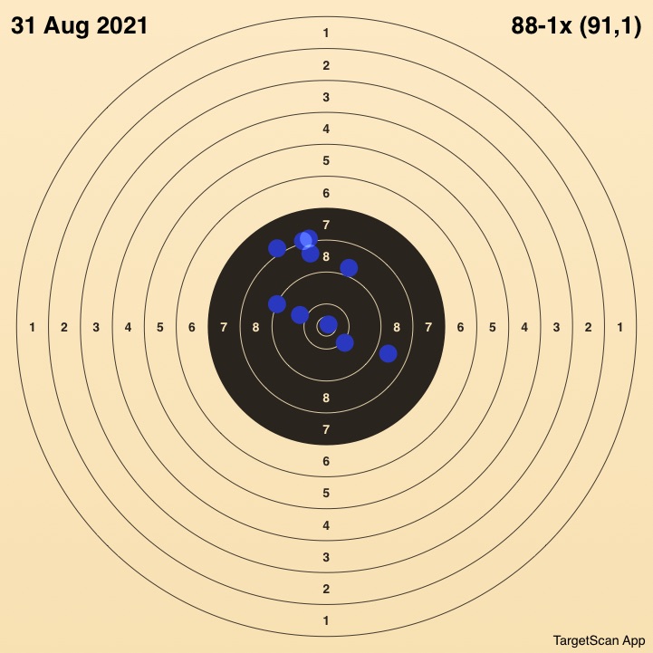

emre-nur
Posts: 193
Re: Newbie shooting question
Post by emre-nur »
Those are two 10 shots from today.
Was I watching my sight properly, calling my shot? Ehhhhh, not exactly, so so.
william
Posts: 1467
Post by william »
emre-nur wrote: Tue Aug 31, 2021 8:04 am
Going there.
Don't check each shot to see its point value. The score is of no importance in practice. Check every shot to confirm that it hit where you predicted it would at the instant of trigger release, or to determine what you did wrong if it didn't. Then scrub that shot from your consciousness (easier said than done) and move on to the next 'one-shot-match.'

emre-nur
Posts: 193
Post by emre-nur »
All right...
This time, I tried to do all by the book.
Watching my sights, abandoning prolonged shots, not leaving my PoA before 5 shots.
My main concern was calling the shots.
I almost knew all went around 8 and 9 and I knew that some were low (maybe even 7) but also hoped to have one or two more 10s. I thought one or two could be higher but not up to 7 or exterior 8.
Not a better score, but maybe a better grouping. At least less like a shotgun spray, as William tells.
Here comes the think, I have a W. LP500 since june 2021 and I never tested the gun for sights. I am shooting almost as it came from the seller (adjusted windage a few clicks). Sights were adjusted like 6 or sub6 and I went with it. But I dont know where exactly the pistol shoots, rather going intuitively. Now as I focus on watching my sights and keeping a more or less stable PoA, groupings seem to be a bit low. Yet, I still feel that it is early to make major adjustments. I also dont know whether to aim 6 or sub6. Before LP500, I had an Izzy46m and was shooting at the center for 2-3 months.
If you don't know where your pistol is shooting, it doesn't matter. All you are concerned with is grouping.
But since you bring it up: Shoot a target, put another target over it and shoot it, then do it again. You'll have thirty shots on one piece of paper. Then adjust your sights (about four clicks per scoring ring). Now do it all over again, and again, and again, and again......forever!

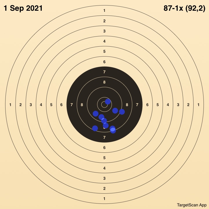

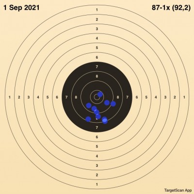

nmondal
Posts: 251
Sep 1 2021
Post by nmondal »
10 shots. Today.
First "cold" shot was 8.9 I think.. but yeah.
emre-nur
Posts: 193
Post by emre-nur »
Rover wrote: Wed Sep 01, 2021 11:17 am If you don't know where your pistol is shooting, it doesn't matter. All you are concerned with is grouping.
Thanks Rover,
I agree that it does'nt matter. That's why I am reluctant to play with the sight adjustment. This targetscan app gives a heat map of the previous shots, like last 1,7,30 days. Do you think this could help?
Play with it. Don't play with it. It's all in your hands. Just don't do it excessively.
