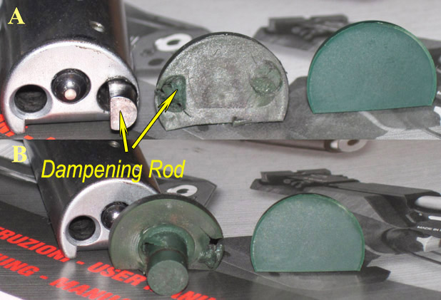

Regarding the recoil dampening rod (and the 13 O-rings) in the Bullseye SP; I got rid of them and rely exclusively on the green dampening buffer. I did this because the recoil dampening rod actually damaged the green buffer (after may be 5K rounds). I spoke to Alex about it and he said that was OK, but cautioned that I should check the green buffer pad regularly to make sure it's undamaged from wear. Attached image shows damage cause by the recoil dampener in the Bullseye SP model. dipnet
Posts: 3567
Re: Pardini SP 4th Round Jams
I'm confused... It may be the bullseye model, but I didn't think pistols with the buffer rod & O-rings in the bolt used the green buffer. Unfortunately, the newer SP's I work with that have the buffer in the bolt are in lock-down still, and I can't check them.

I think they put together whatever they had for a while.
The green buffer is gone now.
Their quality was real poor the last years. Often they did not last a box of Lapua.
I have glued a 2.5 mm thick piece of softer rubber on them. Works, but what kind of glue is tricky. I will try just a dab of the glue gun next.
