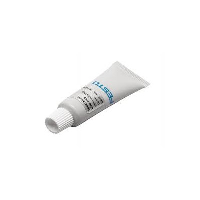

My favorite Airpistol grease is Festo-Pneumatics Lubricants Grease LUB-KC1.
Its main use is when assembling Pneumatic Controls.
Available in small tube.
