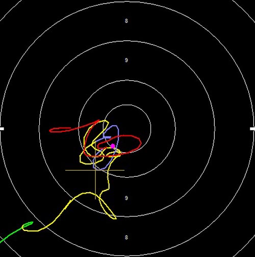

Fellows. Thank you all for offering the support that you have given. I'm finding that I am not so hesitant to "adjust" the (default ?) settings on my Scatt....even if Im uncertain of the outcome.

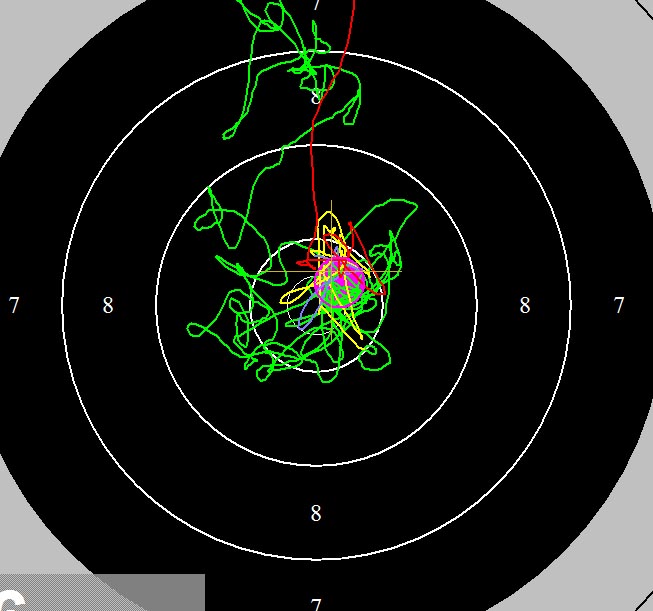

Question. This evening I "shot" 3 10 round strings (offhand) onto a blank (no bull) target. I "think" I read (elsewhere ?) that doing so would get one more "interested" in ones hold rather than shooting the x-ring.
Well... it appears that my yellow and blue trace produces a smaller.... group (?). Maybe I should say that the yellow and blue traces are closer together than when I was "aiming" at a bull.
The issue I have is that being that the "target" is blank my (individual) shot trace can be all over the target shown on my laptop screen. In some cases waaaay off the target screen (the "statistics" still appear). Is there a "electronic" means to "adjust' the shot trace so that it appears over the bull? I'm of the understanding that one shouldn't use the Scatt as a "electronic scoring" tool rather to be more interested in ones trace. BUT if the trace for the shot is waaaay off it doesn't show up on my laptop.
Also. I must have "fooled" with some setting as I am not now apply to save my 10 round strings. I was able to save strings last night. Is there a setting I should be checking to save my strings?
Thanks all,
Lester

I use the back of a target to focus on a quality sight picture that does not get disturbed by using the trigger. You should be able to get a very good group without the distraction of a black scoring area above or behind your sights.

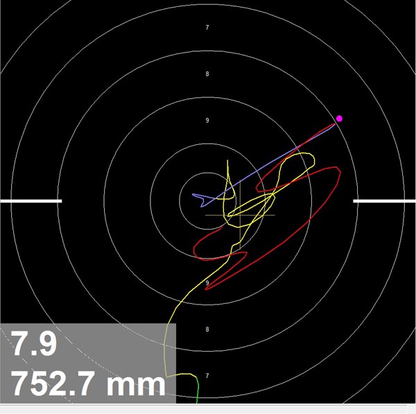

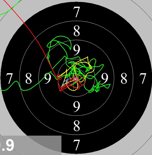

Fellows. I attempted to get a screen shot of one of my "shots" as I have a question about the trace. I couldn't figure out how to do that so I used PAINT to make a quick drawing and attached it to this post.
I fired a final 10 round string tonite and "observed" something that seems "odd" to me, the newbie. On 7-8 of the shot traces (you will see what I mean on my attached drawing) the trace turns from yellow to blue, the shot is indicated by a little gray dot and then the trace turns red (follow thru). What you will notice (and what I see on several of my shot traces) is that right after the shot is "fired" (gray dot) the trace makes an abrupt turn at the same time it turns red.
This "oddity" is not on ALL the shots but 7-8 of them. Where the path of the trace makes an abrupt turn right after the shot.
I'm thinking this abrupt turn is telling me I'm jerking the trigger, or twitching the trigger. Its obvious I'm inducing something to make the trace turn so sharply after the shot.
Thoughts?
Also. I reread the postings on setting the "F" function. I think I have mine on 10 but I would like your input being that I'm using my Scatt on a AR with a 20" barrel . Velocity of my cartridges is around 2750 fps.
Thanks Fellows.
Thoughts?
Thanks Fellows.

Re: SCATT data interpretation & usage links
Yes, that is telling you something. If you look at the trace speed values for those shots, you will probably see the blue line speed is higher than the yellow line speed. This tells you that the gun is accelerating as you are triggering, usually from jerking or snapping at the trigger but can also come from other things like tensing muscles, flinching, changing the trigger hand grip as you are triggering etc.
The point about Scatt being a "real time" training tool has been made above and this is an example of why. You will never remember what you did and felt on that shot later or tomorrow but looking at the trace and numbers immediately after the shot gives you the opportunity to correlate things and figure out where the movement is coming from or what effect a change has had on your movement.
The pattern of the trace line tells you alot about your position and hold. For example, when you have straight lines, particularly horizontal ones that abruptly change direction as you have depicted in your illustration, usually indicates a lot of muscle is being used in the position.
There are good examples of what a good trace should look like in the information files of the system.
As for the F coefficient, it really does not tell you anything important, the useful information is in the numerical data.

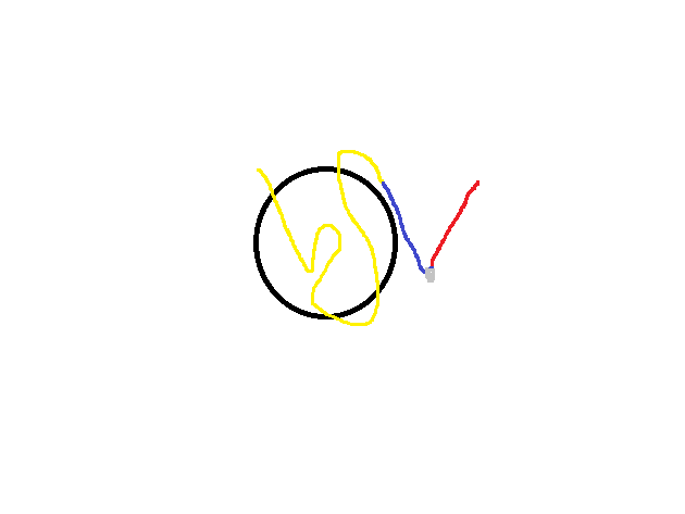

Straight lines are usually not good at the time of release. Attached example of a poor shot release. X-ring to 7 ring and back to the ten ring in no time at all. First picture better trigger release but still trace changed direction at point of release. Both R/F pistol, 3 seconds to fire the shot.
Fellows. Can't tell you all how much I appreciate your input. I do believe that this (Scatt) "investment" will be a great tool for me.
KH250... You mention that straight lines are not usually good at the time of release. Should I assume then that the yellow line then followed by the blue line should be making a (smallish ) circular trace (hopefully) atop of the X?
A little history. Most of my range time the past couple years have been spent "practicing" offhand shooting with my AR. I did/do "ball and dumby" drills which if you are not familiar with the term (for me) is comprised of "firing 5 live rounds and 5 dumby rounds. I mix the 10 rounds together in my shooting coat pocket and randomly draw them out (w/o looking), chamber and then fire them.
What I have observed is that on occasion (perhaps more often than not) I will...what I call.... launch the round when I get that "perfect" sight picture. Its as if I'm "firing" a torpedo. As if you were watching an old WWII submarine movie when they "fired" a torpedo. The torpedoman smacks the launch button just after the Captain spots the enemy ship in the crosshairs of the periscope.
With a dumby round I really see this action as the muzzle usually dips down (not up). With a live round not so much.
I've tried my darnest to "cure" this issue but not know what causes it I'm not certain what to do to "fix" it.
Yesterday I tried 2 "new" things on the Scatt. I used my A2 rifle (open/metal sights) instead of my scope equipt rifle. I was thinking that the use of optics is causing me to try to hard (longer time) "perfecting" the sight picture. The result was a bit of a reduction in the "abrupt" turn of the yellow to blue trace when I used my A2.
BUT... the 2nd "new" thing I tried was getting into position, aligning the rifle up with the target as best I could and "firing" the gun ...with my eyes closed. I wasn't concerned about where the trace pattern ended up on the target. Instead I saw that this "abrupt" turn issue was only on 3 maybe 4 of the shots.
I only shot one 10 round string as I had other activities to go do but what is your thought on this "shooting with eyes closed" telling me....if anything? Not that I would do it for real.
Once agian thanks for your input.
ptf18
As a pistol shooter I realise that the pistol never stops moving. The best I can do is squeeze the trigger progressively when the pistol is in the correct area, not spot. The ideal result for me is to have the before and after scatt trace to be on top of each other. Pictures attached 3rd and 4th picture.
I travelled 271 mm in the last second, the 10 ring is 50 mm across. All I can hope for is to shoot into my hold, I cannot pick the perfect time when the pistol is in the x-ring to release the shot. With perception time and reaction time I will be somewhere else by the time the shot is actually released.
I crossed into and out of the x-ring 5 or 6 times in the last second.
I shoot with a one handed unsupported hold with a 1100 gram pistol with a 1 kg trigger. Any changes in grip tension when I use the trigger usually disturbs the sights.
I work to improve my stability and stillness. As this improves my hold size shrinks and scores go up.
Closing your eyes most probably helps you because you are not focused on the target and can focus more on better trigger control.
First 2 pictures Olympic level air pistol shooter even with a sub 10 ring hold in the last second they moved 92mm.
Third and forth pictures of a 25 metre target I shot showing what I want to achieve. Shot inside the hold with the follow through over the top of the pre shot release trace. Notice the speed of the trace in the last 250ms, it was not higher than the 1 second speed. I want the speed to stay the same all the way up to the shot release.
