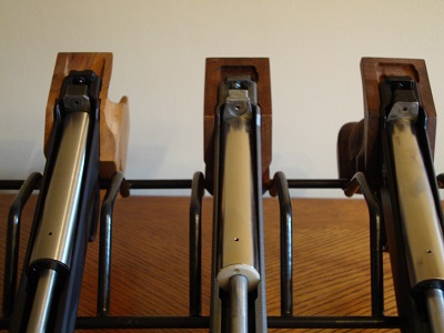

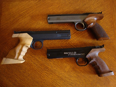

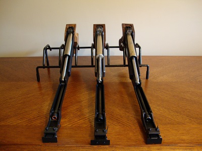

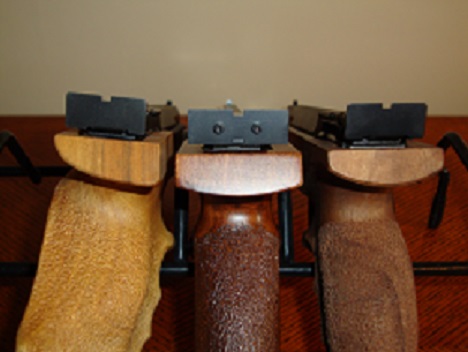

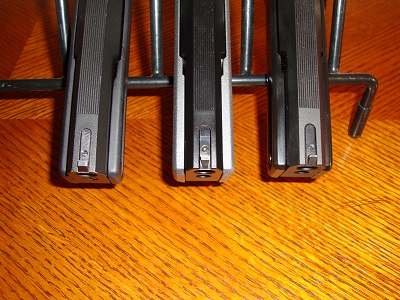

I have attached a few photos of my pistols. I've kept them in order with the oldest 604 to the left, the newer 604 in the middle and the 6004 on the right. Another thing I noticed is the block containing the transfer port has a flat surface like the old 604. You can see on the newer 604 that there is a channel that the barrel fits into. From shooting I would say it makes little or no difference that I can see. The block on the 6004 isn't as smooth on the top or sides as the 604s but that's just cosmetics. I was shooting the 6004 the other day and got some tight groups with JSB Match 4.49 (green tin). It does seem to shoot a little high but that might be my sloppy form as I am a little out of practice. Hahaha
FAS internals.JPG (55.27 KiB) Viewed 24283 times
FAS F sights.JPG (87.67 KiB) Viewed 24283 times
FAS Ports.JPG (52.58 KiB) Viewed 24283 times
FAS 3Pistols.JPG (76.59 KiB) Viewed 24283 times
