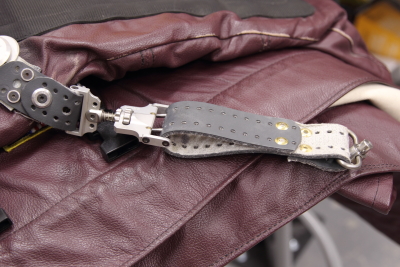

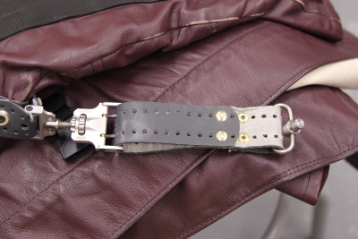

Here is a solution to the adjustment pins pulling through the strap. The only problem is you need to have adjusted the sling to it's final resting place. The only adjustment left is the small adjustment screw which is limited. It should not be a problem for shooter who have refined their position to the point that the sling stays in one position. Hope this helps someone.
Ed
Ed
- MEC Sling_08-13-14_0005.JPG (131.52 KiB) Viewed 3822 times

Ed:
I thought about doing what you suggest, but in Palma and LR shooting (on grass firing lines) you never know what condition your firing point will be in. Some slope and I find I need sling adjustments. Bringing tools to the line (especially to mess with the flat nuts and screws MEC provides) doesn't seem a good option.
Most smallbore ranges are great for maintaining a common position (especially with the Nationals in Bristol...........Perry had some awful points down in the moguls that I dealt with the past two years!). You needed a bag of sand, and a bunch of underlay material to have any hope of a flat point!
Thanks for the pictures though!
