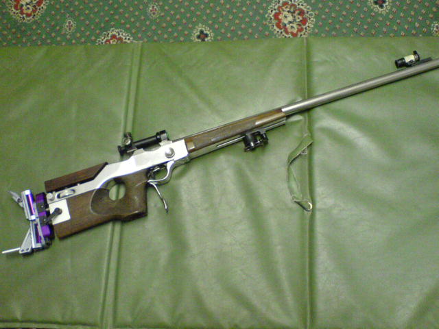

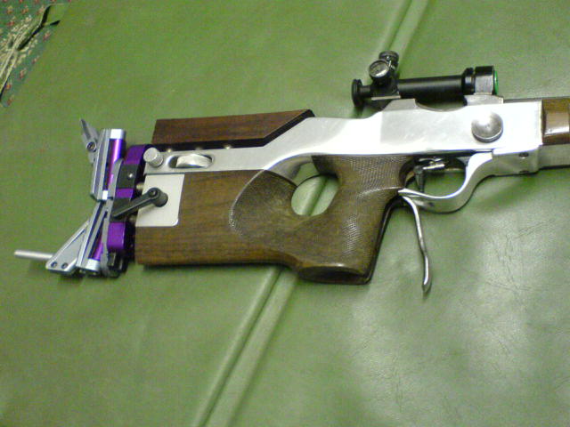

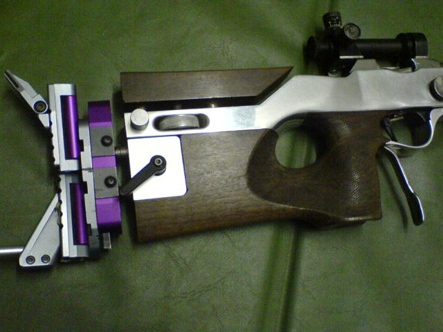

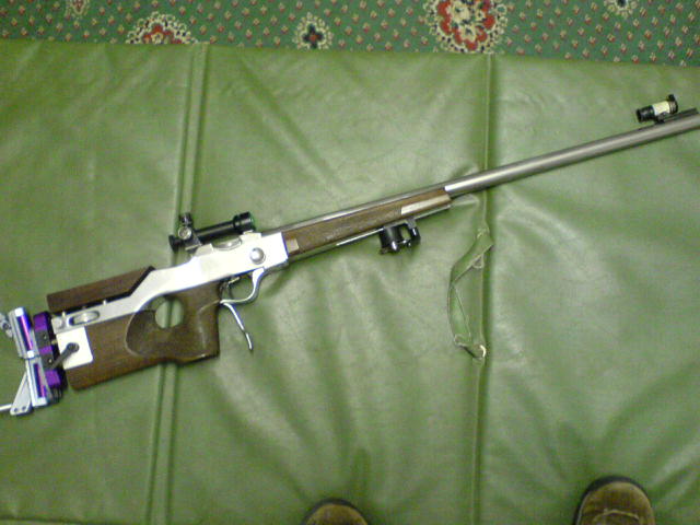

Ali Martini Pics
Here are some pics of the MK2, which unfortunately I no longer own.
I will try to post some pics of my Mk4, with American black walnut wooden thumbhole stock.
Walter

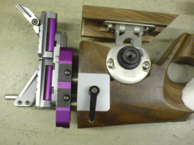

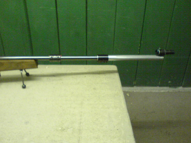

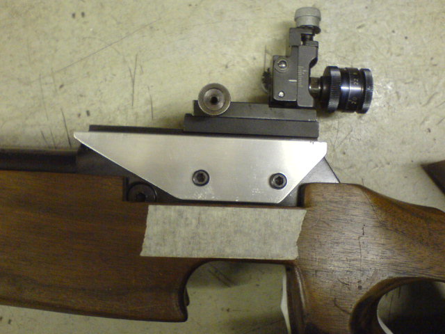

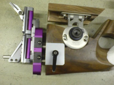

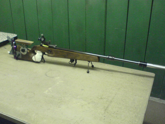

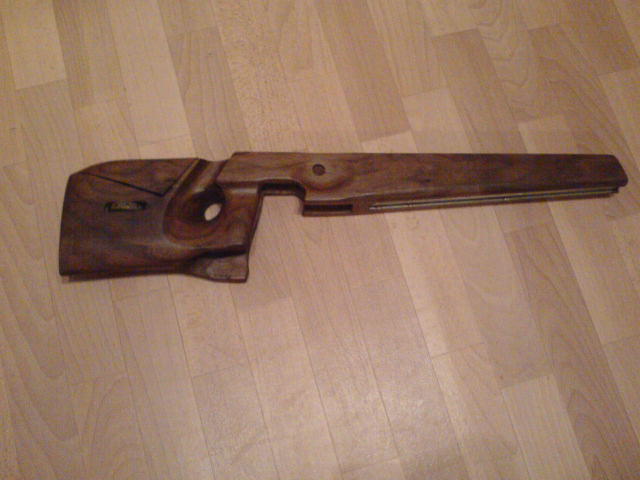

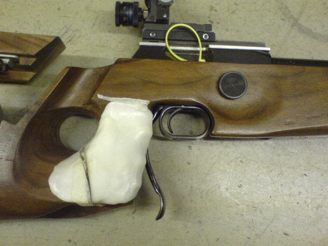

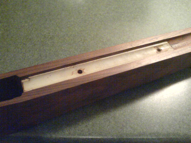

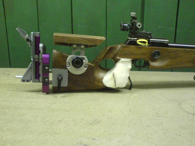

Mk4 Thumbhole stock
Here are some (poor quality) pictures of my Mk4 ISU. The stock was built by the same man who built the ali stock, a guy called George Simpson, who was a gunsmith in the North East of England. Most of his work was on pistols, and after the handgun ban in Britain in 1997, he retired and went to live in Scotland.
He not only made ali stocks for Martinis, he also made them to fit Anschutz round actions, ie Match 54, 14/16/18/19 series.
Just like the ali Martini stocks, the common denominator is weight. They are VERY heavy, which is one of the reasons I sold mine.
As Tim says, the Ali stocks have the barrels glued in.
The Mk4 wooden stock has an unusual bedding system. If you recall, with the standard 2-piece stock, the forend is bolted to the barrel with 3 bolts.
With the wooden thumbhole stock, the barrel is bedded into the stock on the centre and rear bolts. I was given the stock by an old chap at our club, without butt plate or bedding bolts, and with the bolts having an unusual (these days) British thread, new bolts took some finding!
Whilst it had an adjustable cheekpiece, it would hardly budge. Not the best design. I was fortunate enough to find a cheekpiece from a 20 Series Anschutz, so had that fitted, together with a block to fit my Gemini butt-plate.
As I wanted to use an Anschutz rear sight, I made a base (with hack-saw and file) to clamp to the side of the action, instead of the normal sight-block. I had an old dovetailed sight-base someone had made, which I fitted to the top of the new base, then after fitting a Barry Nesom tube and turn-over sight I was good to go.
I love shooting this rifle, but it doesn't group as well as my 1607, which I put down to the unusual bedding. I need to see what I can do to improve the grouping, then I would happily use it all the time. Sorry about the picture quality, I will try to get some better ones.
Walter
