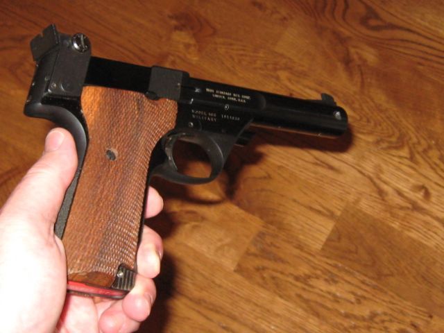

High Standard Recommendation
I know the horror stories. Probably why I own 6 of the Hamden models. The Trophy's normally get the nod, since they seem to have the best triggers and no ejection issues since they do not have the Victor's vent rib. Contrary to popular myth, the "new" Texas High Standard produces some fabulous pistols and spare parts. I use 6 of their new mags, and none needed to be tweeked by the mag-lip adjustment tool, although I do own the tool. I also have one of their new blued barrels on a Trophy frame, and it is as accurate if not more so than any of my Hamden barrels. However, you MUST buy the magazines from new stock. The mags from the first 3 years the factory was opened did have weak metallurgy, long since corrected. Even a NIB Trophy is affordable, and considering I shoot a Pardini SP-22 only because it has a red dot, the Trophy gives up nothing to a S&W 41 or Ruger. I had 3 41's at one time, none were ever selected to compete with, after I sighted in the Trophy. Be alert though, in all fairness aint nothing wrong with the Ruger or 41, it is just personal "feel". Furthermore, if you buy an old original HS, check the frame under the grips for frame cracks first. They Cannot be used with HV ammo, and you do need to replace the recoil spring every 3-5k rounds.
Best of luck on a tough choice!
Amanda
Amanda
When I said that the early Texas models were no good, I was not passing on a rumor, but I said it in light of my personal experience along with many others in our Bullseye group. The barrels from one gun to another weren't even interchangable among themselves much less from an old High Standard to a Texas model. People in the know who were shooting old HS's for years and knew how to work on them finally gave up on the Texas model. If the newest ones are good, it is going to take a long time and a lot of word of mouth before any of us would buy one because even if you have one that works good, we have no confidence that you didn't just get lucky. We wouldn't even buy a late Hartford model because of irregularities and slopiness in their manufacture. -- Bill --
- Posts: 52
- Joined: Sat May 14, 2011 7:56 pm
- Location: Beaumont, Texas 77707
Bill,
I understand the concerns about the early Texas High Standard pistols. The best part for me is the fact that they learned from their early pistol and magazine failures, and fixed the problem. All High Standards are Magazine-dependent, and you can get tired and broke from paying the gunshow magazine prices, and even then you won't know if they are "good" until you try them in your pistol. Anyone who owns an old HS knows that they need to have a goodly supply of excellent mags. Texas HS does indeed make nice mags now. Would I trade one of my Hamden Trophy or Victors for a new Texas HS? No, but only because I like blued pistols, and the new ones are Stainless Steel framed. RIMFIRE CENTRAL has a fairly dedicated bunch of HS fans, many who have tried the new Texas pistols. Again, like the mags, they are best to be purchased if made in the last couple of years only. Now, if they would make an all-Stainless Steel Trophy with a high polish, I would break down and buy one.
Better clean my Trophy. I do have a match this weekend!
Amanda
Amanda

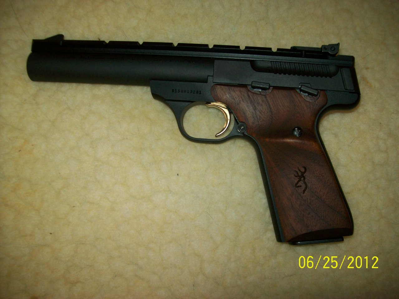

Here is the Browning Buckmark I settled on
A good hand fit..so far. Need some more magazines of course and will eventually get a optic sight.
Am pondering making a set of grips to match my Izzy AP in at least the hand hold part. The slide release and safety latch area will have to be exposed as will the mag release.
yeah I could call Fung and for $180 get fitted target set..But a friend can get me some walnut or cherrywood and get it down to a dremel manageable size. I am patient and will take my time.
Might have to consult a rule book or two to be certain that the grips when finally attached will meet specs. If not..alittle more "dremeling" wont hurt.
