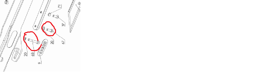

Tonyarg
Joined: Tue Mar 20, 2012 11:32 pm
doubt
Post by Tonyarg »
the front screws are the closest to the trigger? thanks[/img]
Sin título.png (21.61 KiB) Viewed 5257 times
gstarik
Posts: 87
Post by gstarik »
The front screw is the one that goes through the recoil lug.the screw which is close to the trigger shouldn't be used.
Guy.
Tonyarg
Post by Tonyarg »
Thank you very much!!
