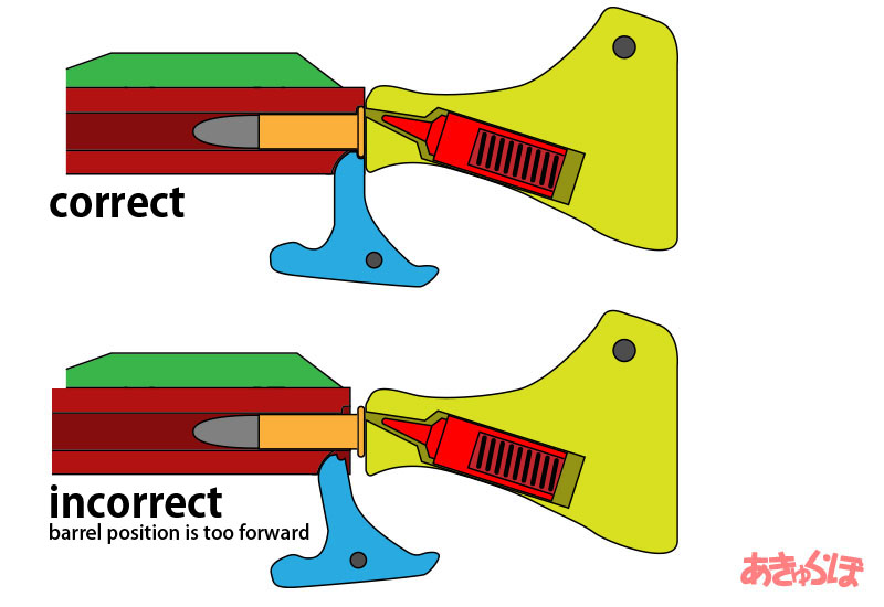

Pure speculation: if the barrel is too far to the rear, the bolt will not close perfectly, the gun should not fire. A buildt-in safety feature.
If the headspace is at mimimum, and some force is applied to chamber the chartridge, this may explain why the gun sometimes will fire, sometimes not. Just my 5 cents...

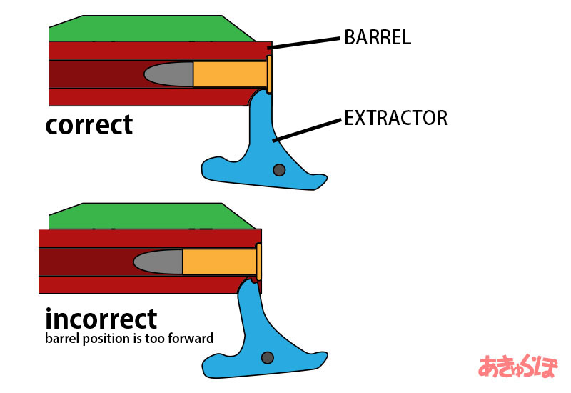

The case bulges and ruptures I'll take the blame for and ascribe to a too-loose headspace (although I still think the groove in the barrel is way too deep), which would also explain the light hits. As the barrel pushes forward (increasing headspace) the extractor (under spring pressure pushing it against the chamber groove) goes with it, pivoting lower and lower below the edge of the chamber. The back of the extractor is curved, and the extractor slot is actually the end of a long groove cut in the bottom of the barrel, so it simply slips down as the barrel moves away from it.
