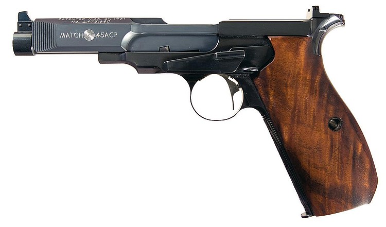

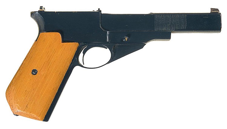

I ran across this design recently that was a prototype by High Standard engineer George Wilson in the early 1960's for Bullseye competition:
http://www.forgottenweapons.com/other-h ... -match-45/
http://www.invaluable.com/catalog/viewL ... =c&ri=1284

Sa-Tevo,
Thanks for posting the picture and video link for the George Wilson 45.
I remember reading about that pistol in the 1970s, (in Pistol & Revolver Digest or some such publication). Their review was in keeping with the comments in the video. It was very positive with a bit more depth into the design and good insight into the needs of the serious competitive shooter.
It looks like it would be even more costly to produce than a P08 Luger. That's not to say there wouldn't be a ready market....
