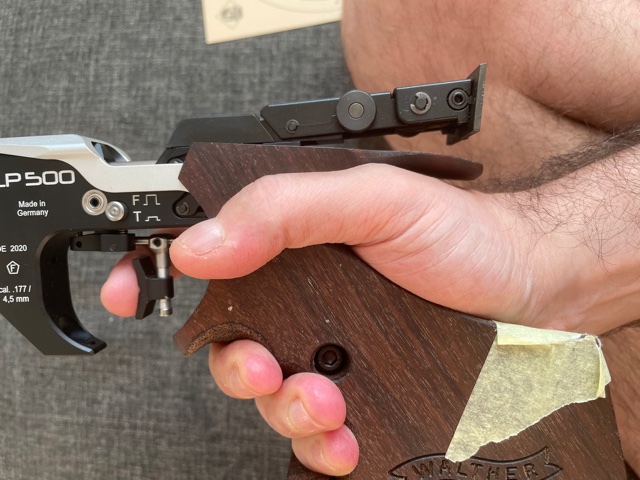

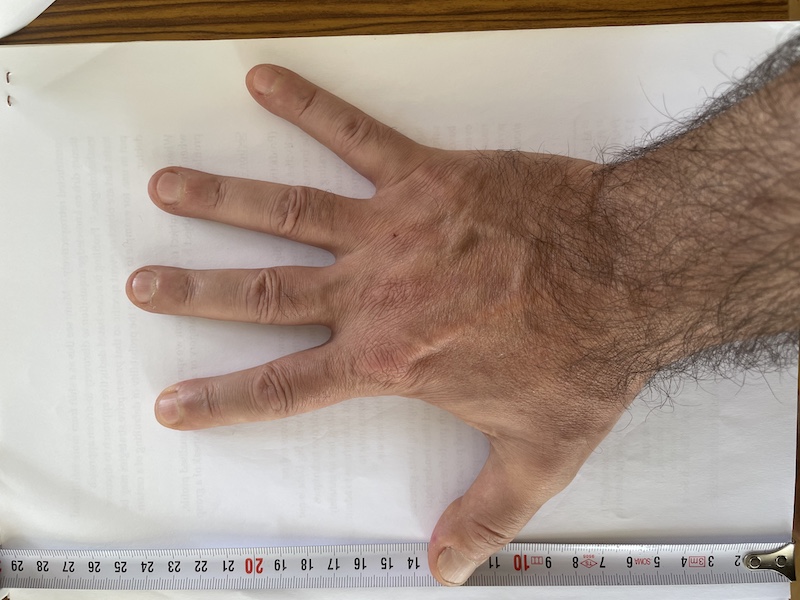

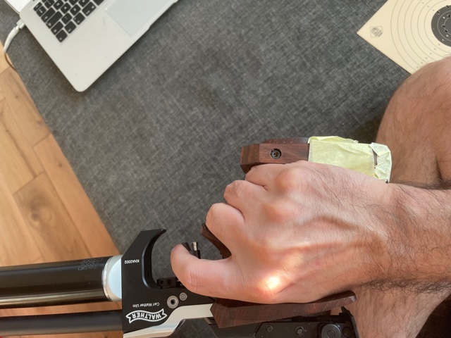

This is my hand drawing - drawn to order Rink Grips.
You still think this is not a problem? Even with an Small size grip.. I am having trouble pressing triggers consistently.

nmondal wrote: Wed Jul 28, 2021 10:29 am This is my hand drawing - drawn to order Rink Grips.
You do have small hands, but your trigger finger is on the long side compared to the rest of the hand, which should help.
What part of your finger are you putting on the trigger? The most sensitive part is the pad at the tip, about where the whorls of your fingerprint are centered. That's what you want to use for precision shooting. You can find instructions for shooting heavy combat triggers that say you should use the groove of the first joint, which will really screw things up.
IDEALLY, you want the pressure to be straight back, inline with the bore when the shot breaks. Not at the beginning, not at the end.
One problem with fancy "orthomanic" grips is that it's hard to shift your hand around to reach the trigger if things aren't right. With a lot of older pistols without adjustable triggers, that was your only option. You had to compromise between a good grip & a good trigger position. Generally a good grasp on the pistol is more important.
Some people will mess up their trigger reach by rotating their hands around too far behind the grip. Ideally, you want the bore to line up roughly with your arm, with no twist right or left in your wrist. If you just relax your hand an raise it up, that's the position it should be in when holding the pistol. THEN worry about the trigger position.
If the reach to the trigger isn't perfect, it's not the end of the world. As long as your trigger squeeze is consistent, any deflection can be tuned out with a sight adjustment. I see NO evidence in your groups of an excessive horizontal spread that couldn't just as easily be due to anticipation & grip issues.
Again, if you are REALLY good at calling your shots, and your trigger is too far forward, you should see the pistol consistently deviate a little to the left a tiny bit as you apply pressure (I assume you are right handed). You get exactly the same effect if you tighten up your finger tips (and generally with a much larger deflection), so it's hard to be sure what is going on. I would estimate at least 95% of the shooters that pull their shots left are having grip issues more than trigger position problems.

Gwhite wrote: Wed Jul 28, 2021 11:05 am

Your trigger finger position looks fine, and it appears you have room to adjust it fore & aft a bit. Build up your palm shelf & get busy working on your trigger control & sight alignment.
