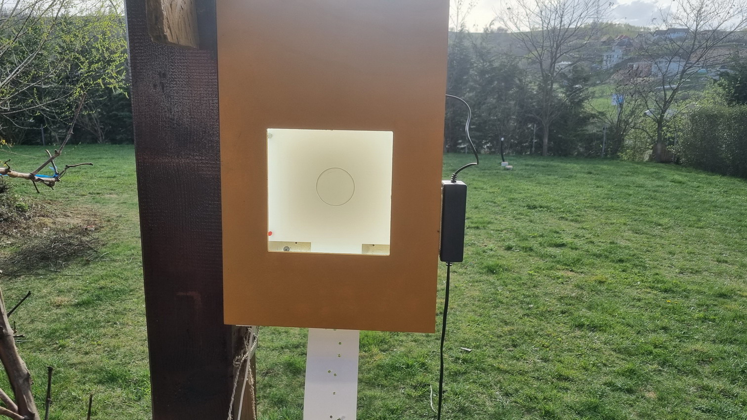

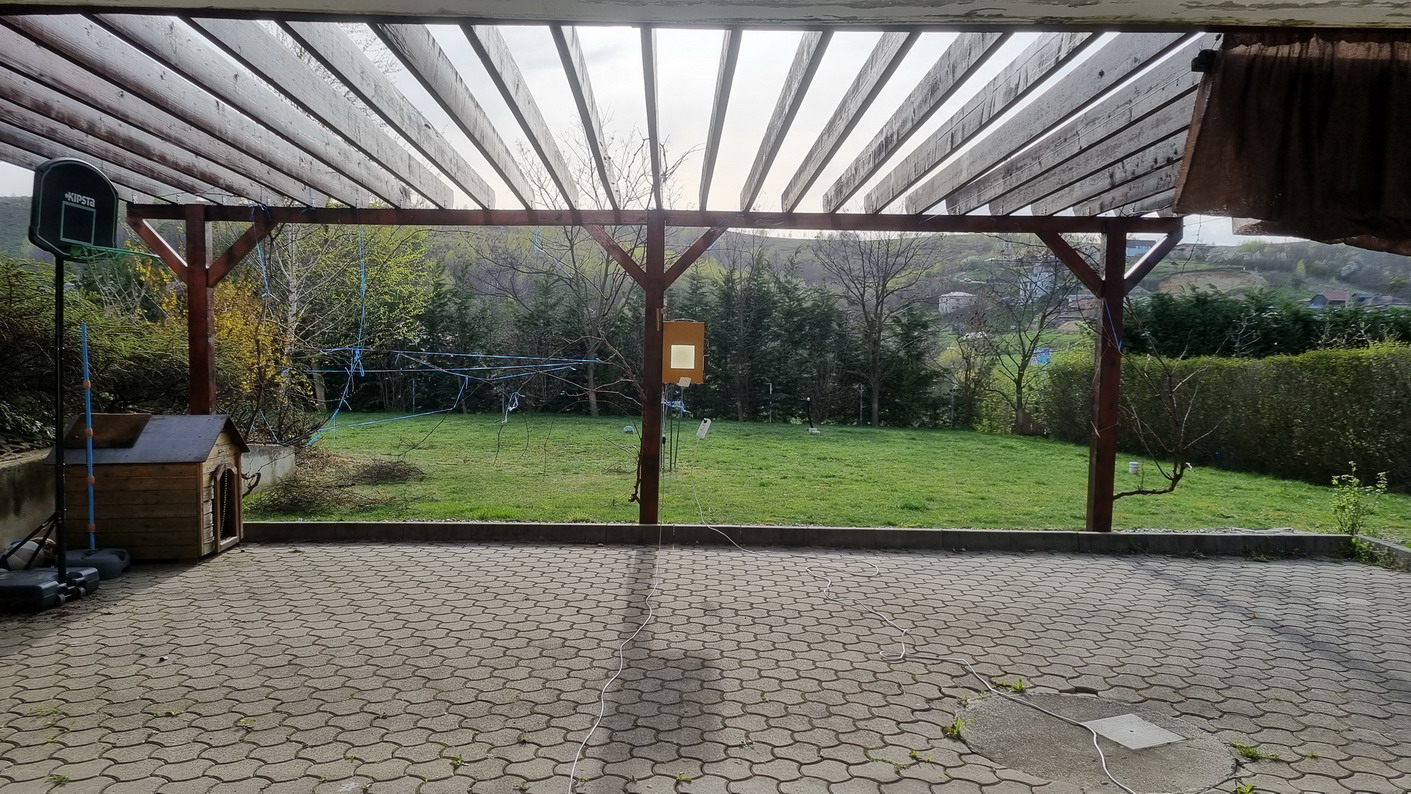

just to note on the "blank target" and "distracting holes" problem.. i have the same thing.
so i modified a paper mask (glued a white sheet of paper on it) and used white thermal paper -> to get a permanently white on white blank electronic target

What a great ideal AZ, and yes gets around the holes putting you off, the SQ ET has a blank target to use but will try your idea with my freetarget at home.
