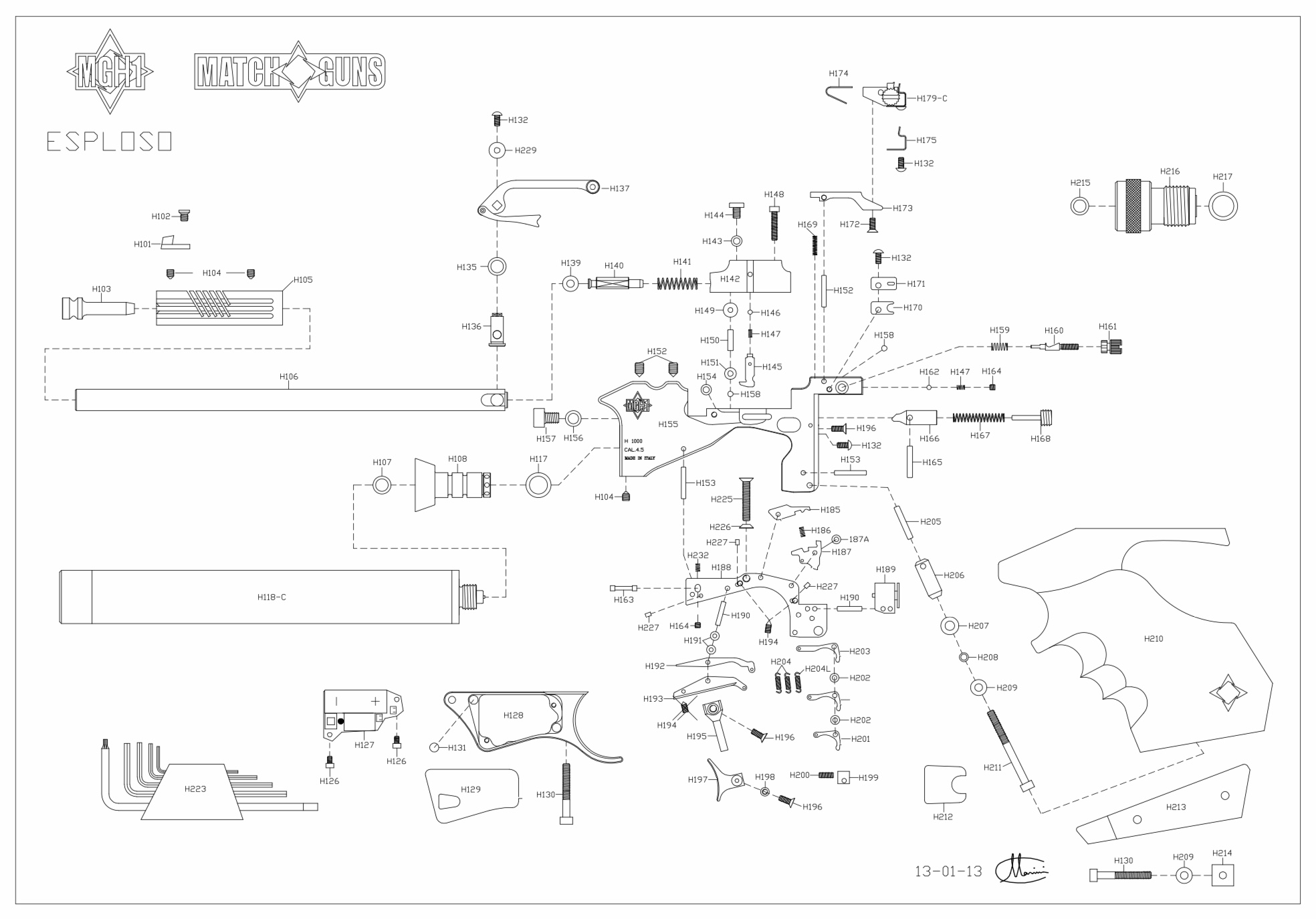

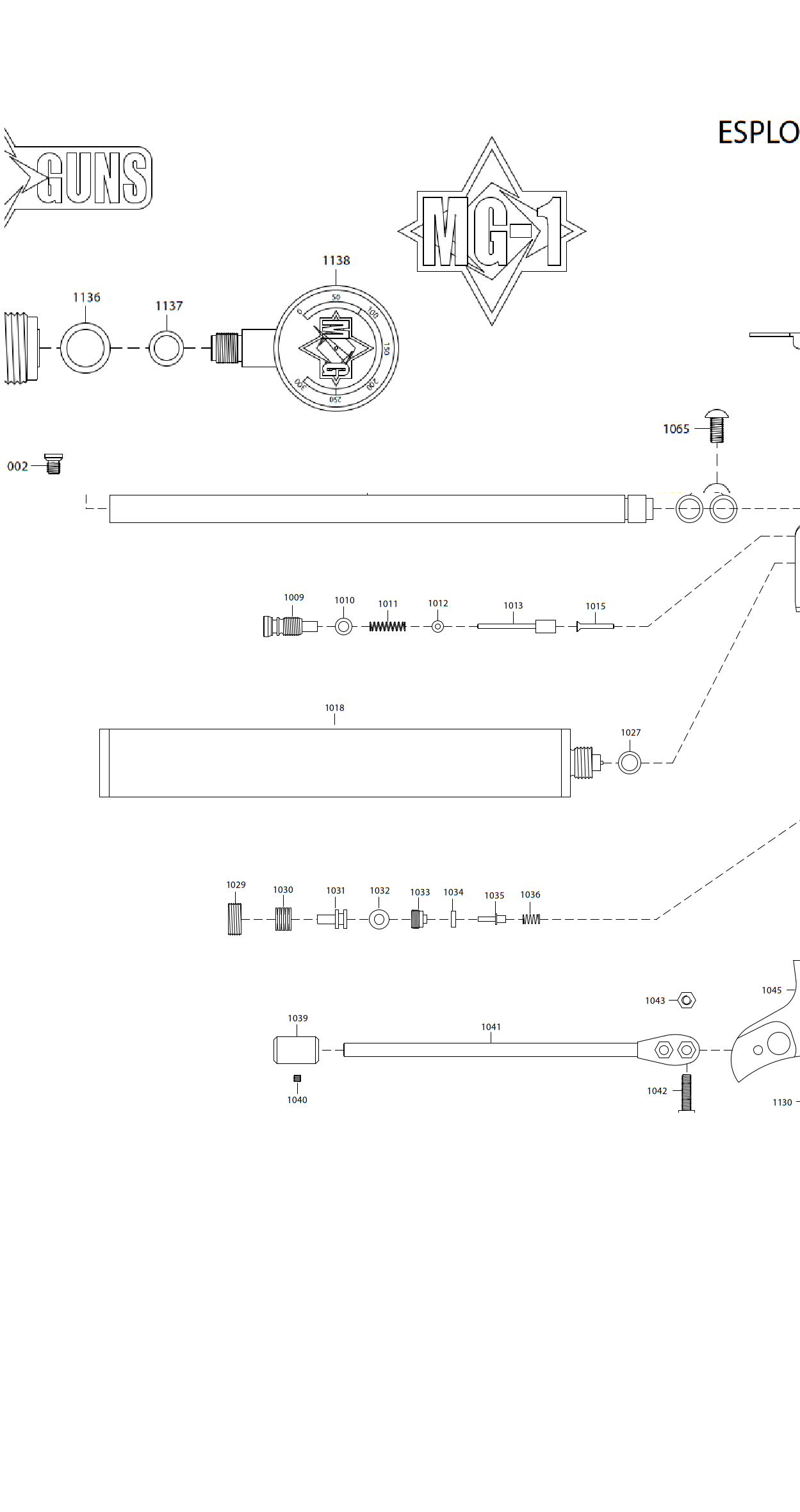

perhaps matchguns mg1 (not mgh1) is a better match. also a good source is user sniper70 in airgunsitaly.it forum as he had repaired/serviced both M10 / Matchguns MG1.
