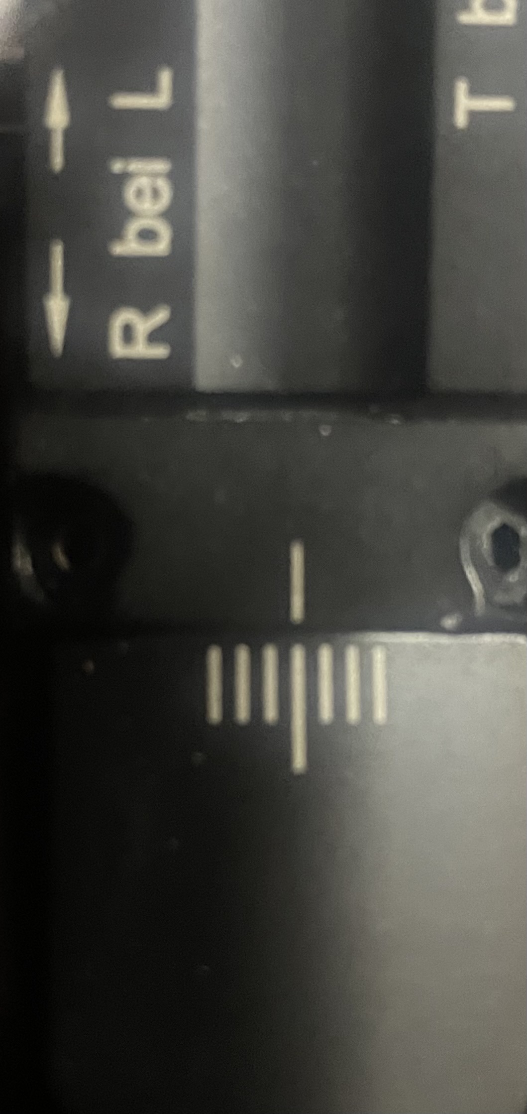

I have a simple question: what is the use of inclinate the sight to the left and right (not to go the shot more to the left and right or up and down) but to tilt the back to the sides in air target pistols?

See previous response. It's about what is a comfortable hold.

Its a throwback from rifle sights.
Some pistols use rifle sights which can still be canted.
How do you cant the foresight on a pistol.....?

I've seen at least one where you can rotate the entire front sight mount around the axis of the barrel. Not sure who made it.

The P44 front sight can be rotated.

About half of the current crop of competition air pistols can rotate the sights.
On the Feinwerkbau P8X and the Walther LP500 you can rotate the front sight mount. The Steyr EVO10 can tilt the foresight in itself.
It's in my opinion one of those things that are relatively easy to do and pad the feature list, but are ultimately somewhat vestigial. As long as you tilt your sights consistently it doesn't really matter. And if you drift then the adjustability doesn't help with that either.
This feature also only really exists on Air Pistols. I'd prefer a uniform tilt on all my sights over having a different picture on my AP vs any of my other pistols.

It's useful if you shoot from left hand and have right eye dominant and vice versa.
