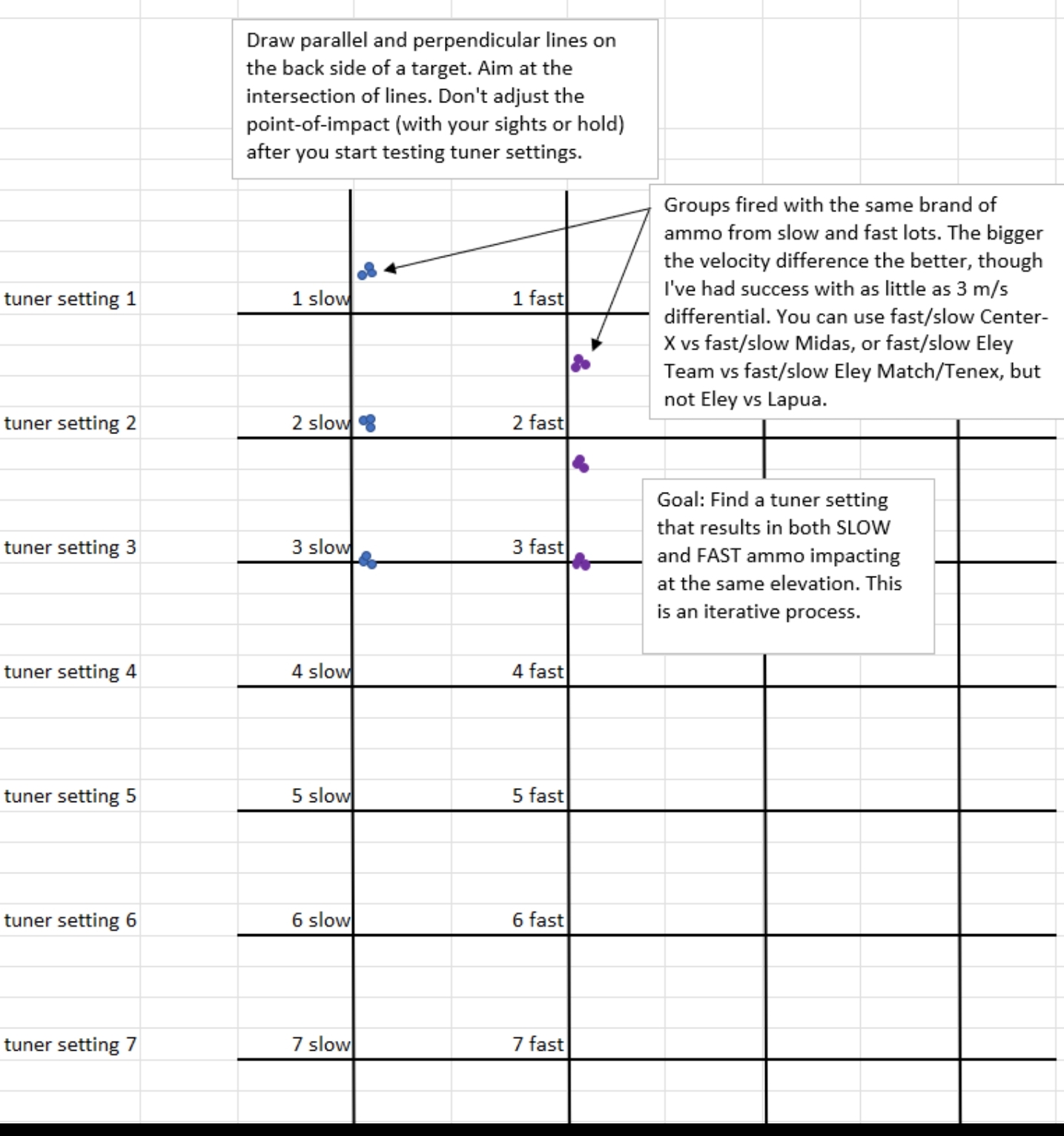

I normally do it using the positive compensation method. Here are a couple videos that Starik did explaining the method.
Video 1: https://youtu.be/lgRRvMhJK58
Video 2: https://youtu.be/xi1n_aozD50
Here's a graphic I made showing how I do it.
![Image](%5Battachment=0%5DSmartSelect_20230708_222109_Gmail.jpg%5B/attachment%5D)
I normally do it at 50yd or 50m instead of 100yd. Doing it at 50 tends to go a bit easier because there isn't as much group size variability. In my experience, the 50y positive compensation tune setting gives good results at 100yds.
