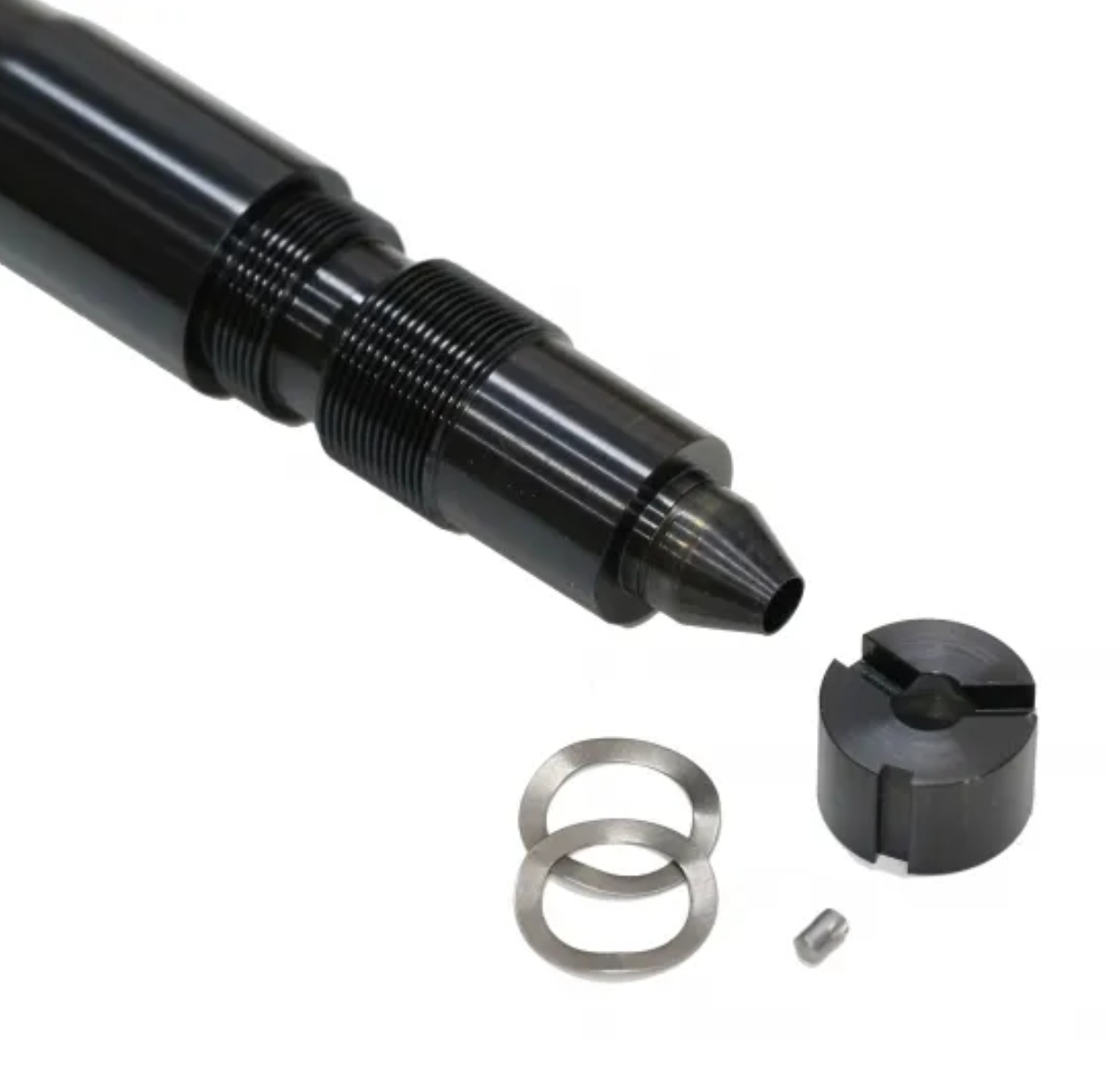

So I've learned more since originally posting. Semi-prefit barrels are available from Anschutz, but they do need to be headspaced. I'm not clear how the headspacing occurs, maybe with spacers.
If you are in the US, Anschutz North America (GSI Inc in Trussville, Alabama) has replacement 54.30 barrels in both blue ($395 USD) and stainless steel ($475 USD). They will install and test fire the barrel for $75 USD. Sounds like a good deal!
