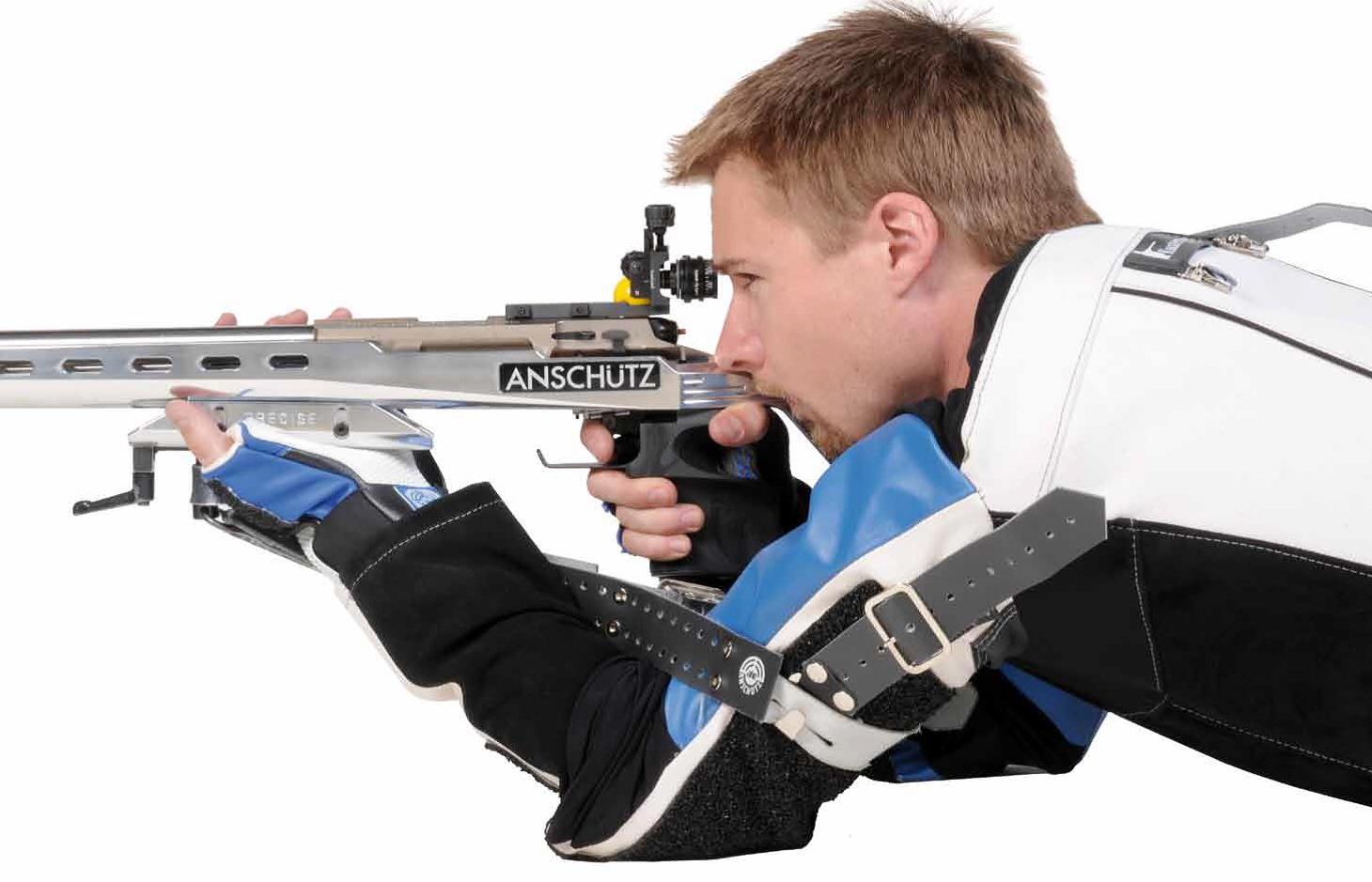

Alternatively Matt Emmons uses a fore end riser to get the same head position (although I know this is an old photo) raising the whole rifle as opposed to just the sights. I also like the idea of raising my right hand up too.

Bryan996 wrote:Alternatively Matt Emmons uses a fore end riser to get the same head position (although I know this is an old photo) raising the whole rifle as opposed to just the sights. I also like the idea of raising my right hand up too.
His eye is impressively well aligned, I must say, and he looks comfortable. And, yes, now that I think of it, a slightly more vertical right hand would seem to have the advantage of increased stability and control for the trigger finger.
The fore end riser does, however, rather negate the advantages of a shallow fore end, but perhaps the modern fashion for the latter is overdone? If so, what am I doing with an expensive Gemini stock? It's all getting a bit confusing for the poor old, very average club shooter.

Roger,
I wouldn't go jacking up the fore-end immediately. Matt Emmons is almost the only male shooter at that level who has raised the rifle*. Since he switched to a Bleiker rifle a few years ago he no longer used the raiser. His position as a whole isn't completely textbook; he lies very straight and has pretty high shoulders. It works very well for him, it's not a variation you often see.
The very shallow fore-end of the Gemini can reduce the leverage that can be applied, much like raising the buttplate does. However, the block that Emmons added brought his cast-alu 2313 to about the same depth as his old walnut 2013. The 2013 does not have a very deep stock, certainly much better than the old UIT standard rifles.
*It's more common among women to ensure clearance from the ground and from the sling.
