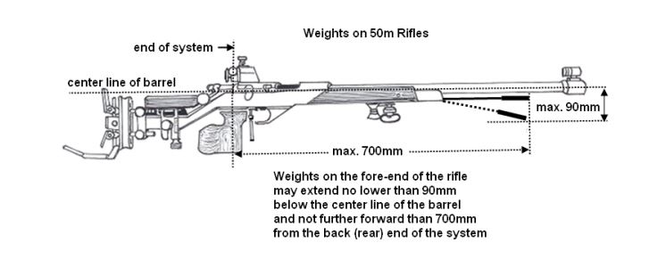

ISSF rule 7.4.5 d)
Weights on the rifle fore-end may extend no lower than 90 mm below the centerline of the barrel and not further forward than 700 mm from the back (rear) end of the system.
ISSF rule 7.4.5.2
Palm Rests
A palm rest is any attachment or extension below the fore-end that aids the support of the rifle by the forward hand in the standing position only. Such extensions must not extend more than 200 mm below the centerline of the barrel.

7.4.5.2 Palm Rests
Does not say can not use palm rest I think you are confusing rest with weight. Weight is not used to support the hand and generally at the front of the stock usually on adjustable rods than can be used to "tune " the stock a bit.
Weights can't extend below 90mm of center , Palm rest can be 200mm from center, A Kneeling rest generally has a rail to attach the sling swivel to and usually not very deep.
http://www.usashooting.org/library/Rule ... e_2014.pdf
- weight.JPG (35.73 KiB) Viewed 3220 times

It doesn't say that a weight cannot, for example, be a solid block running under the forend (provided that it is no lower than 90mm below the CL of the barrel). The rules also do not say that the forend cannot be 90mm below the CL of the barrel.
My reading is that you can have any configuration within that 90mm. In standing you can go to 200mm with a palm rest.
