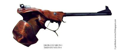

look closely

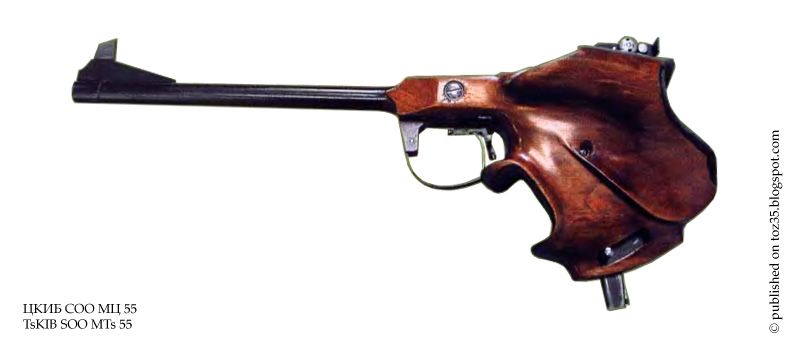

If you look more closely at that picture, you'll see that he is not holding a MTs 55-1. The curved cocking levers in front of the trigger guard are not there. What he shot the record with was a MTs 55 (no dash), the original version of the gun, with an underneath cocking lever, and presumably a very different balance. So I wouldn't draw any conclusions about the balance of the MTs 55-1 (or MTs 55-1M) from that picture.renzo wrote: If you google "Melentiev" you'll probably find an image of him with his record 1980 target in the background. If you compare closely the pistol proportions, yopu'll find (as I did) that the barrel of HIS GUN is approximately two inches shorter than the standard. Obviously, even him had his trouble with the long sight radius and the slender barrel.
The MTs 55 seems to be quite rare these days; I've only heard of one in the US. And BTW, there are at least 2 and maybe 3 different hammer configurations in the MTs 55-1, making replacement of this vulnerable part potentially difficult - don't ask me how I know.

You're right about the Mts-55 with under the grip latch, but if you look to the accompanying photographs, you'll see that the barrel proportions and front sight ramp and post shapes are similar in both variants, and then very different than in Melentiev's, thus my (perphaps adventurous) conclusion.
The info I took was from a fellow (much older than me) FP shooter that visited the U.S.S.R. in 1980 for some sort of International Match I can't remember, probably a pre-Olympic event, and who brought with himself what was later to become MY MC-55-1.

Renzo,
Thanks for posting those pictures - I'd never seen a clear picture of the Mts 55 before. I wonder where the set trigger cocking lever is? I agree with you that Melentiev's barrel does not exactly match either standard model. The length is tricky to figure out, but the positioning of the front sight holder is definitely different.
Also looking at the familiar picture of Melentiev alongside the 2 pictures you posted another question comes to mind. If you look at the top front of the trigger guard in the Melentiev picture, it is contoured like the MTs 55-1 and not like the the MTs 55. Yet the MTs 55-1 cocking levers are clearly not there.
Maybe he really shot the record with a hybrid or a one-off special version, and not either of the standard models? How disappointing for us MTs 55-1 owners - we can no longer claim to be shooting the world record gun ;>)
