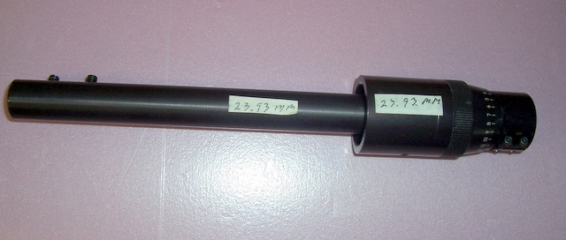

I am not an avid target shooter, more of a hunter, but I have a grandson who has become very interested. Recently we attended the estate auction of Jim Thorp who was the shooting instructor at Virginia Military Institute to purchase some items for my grandson. In one of the boxes we purchased is the item pictured. I am trying to find out what it is & if it is something he might need. More pictures available if needed.

its a barrel tuner. It is really more complicated than what a beginner needs. Don't use it. Let your grandson learn the sport and learn to hold before you start to use anything like that.

As Roo' notes, this is way past anything a new shooter should be working with. As you and your Grandson learn about the sport in the beginning, keep it simple, basic target rifle, sling, glove and jacket that fits helps the new shooter focus on the fundamentals of shooting. Equipment cannot make up for lack of fundamentals.
Now, about this tuner tube. Based on the screws on top it looks like it was for and older rifle (probably Anschutz 14xx or 18xx based as they are common in the US and both used screws to mount a prism block for mounting the front sight). Newer rifles tend to use a dovetail milled into the barrel to mount the front sight. Note the stickers that say 23.93mm. This would likely be the measurement for the diameter of the barrel for which this tube was intended. (0.942"). Unfortunately these things do not just swap from rifle to rifle but are specifically set up for a specific barrel.
You may want to post it in the buy,sell,trade section. Probably get the most use from it by collecting the cash.

Its a Cicognani barrel tuner made in Italy.
This type is mainly used for benchrest shooting, but it's designed so you can screw on bloop tube on to the front of it alowing you to use it as a sight extension as well.

It is a barrel tuner with screw in bloop tube that is tapped for the front sight. I loaned it to Jim a couple of years ago for one of his shooters to try.
