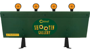

I have a moving target set up and would like to back it up with a trap maybe I could use 2 or 3 outers traps behind it as its 3 feet long. With the concrete wall behind that. See pic of moving target. Feedback wanted! Thanks Ron

Since this is an Olympic style shooting site, I assumed that your proposed indoor range was for this type of shooting, i.e. paper targets. I would NOT put a "Caldwell Shootin Gallery" in the basement. The targets are steel. This would result in lead dust and lead particle splatter in all directions which would soon create a lead contamination problem. There is also a good chance that it would result in dangerous ricochets and or bounce back unless placed at a distance of 75 ft. or greater, according to the manufacturer. Take your fun target system to an outdoor range.

Building a .22 caliber range in your basement is a bad idea. First you have ricochiets. Even if you have a backstop, it could hit a wall if it rcochets from the "shootin gallery", and most basements walls are concrete, and that makes bullets ricochet like crazy. You also have to be worried about lead contamination. While a one story range where noone lives might have adequate ventilation, the lead dust could go to other stories of your house where it might not be properly ventilated, and you will live there. Also, the noise will probably be just insane.
