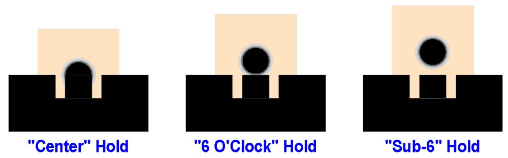

Nothing new under the sun... This is a rarely used hold called "line of white". It has a lot of the same issues as 6:00 does, in that it encourages trying to aim at a precise point, which nobody is stable enough to achieve. The sub-six hold is also referred to as "area hold", to emphasize that you need to accept the size of your hold (wobble), and just shoot.
It sounds like your sub-six was too low. Unless you have huge gaps on either side of the front sight, it doesn't sound like the setup recommended 4 posts up.

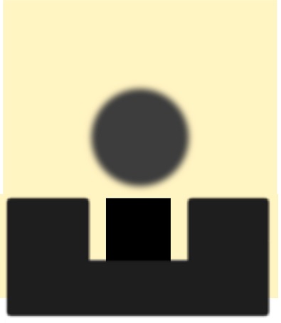

Re: Can anyone convince me to keep using center hold for 10m?
GWHITE that’s the best graphic I’ve seen that explains why a sub six works. Thanks for posting it.
GWhite's schematic pictures, above in this thread, are excellent sight picture illustrations.
