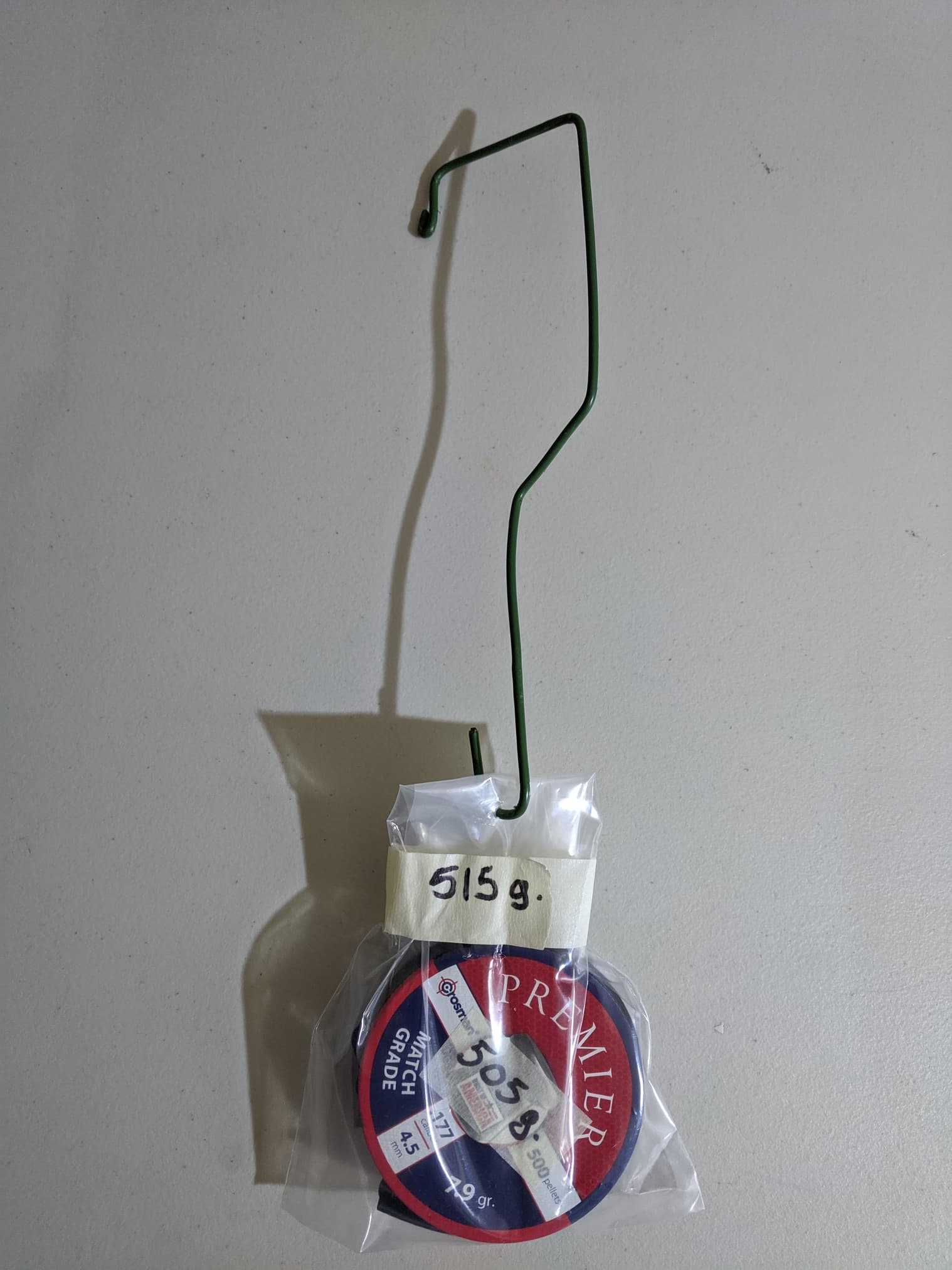

- The pistol is set (on the bench, by dry firing) with the first and a second stage (at 515g).

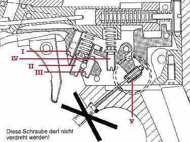

I was able to "solve" the problem yesterday evening by looking at the drawing attached.
(this is the trigger of a used LP2 of which I don't know the history, so I am making a lot of assumptions here)
First I fully unscrewed (I), (II), and (III). This should get the longest first stage with the minimum weight possible.
Verified than the pistol was still firing like if it didn't have a first stage, and without the tip of the screw (III) touching anything.
At that point, the only possibility seemed to be the sear not being engaged well enough and the pistol firing not because the tip of (III) pushes the lever, but because the hold at the opposite side of it is lifted.
I unscrewed (V), the screw Steyr says shouldn't be adjusted, ever :-) by a tiny fraction (red paint seal was still there, but it wasn't securing the screw) and then adjusted second stage weight (IV), and the first stage length and weight.

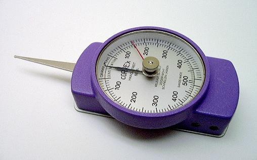

Easy way to set trigger weight stages.
Correx tension gauge 500g model.

David, how do you make sure you are pressing always in the same and "right" direction to get consistent readings?

The Tension gauge is used to set the first and second weights.
Pressing the tang on the centre of the trigger you can feel each stage and read the weight increase of each directly on the dial.

Thanks David. I know what it is for and how it works. My question is about how to consistently take good measures. If the device is not perfectly perpendicular to the trigger weight anf you don't push it in a straight line perpendicular to the pistol you will not get a precise reading, would you?David M wrote: ↑Sat Aug 17, 2019 5:59 am The Tension gauge is used to set the first and second weights.

When I tried one with my free pistol's ultra light trigger I couldn't reproduce the same movement every time amd the readings where too different.
