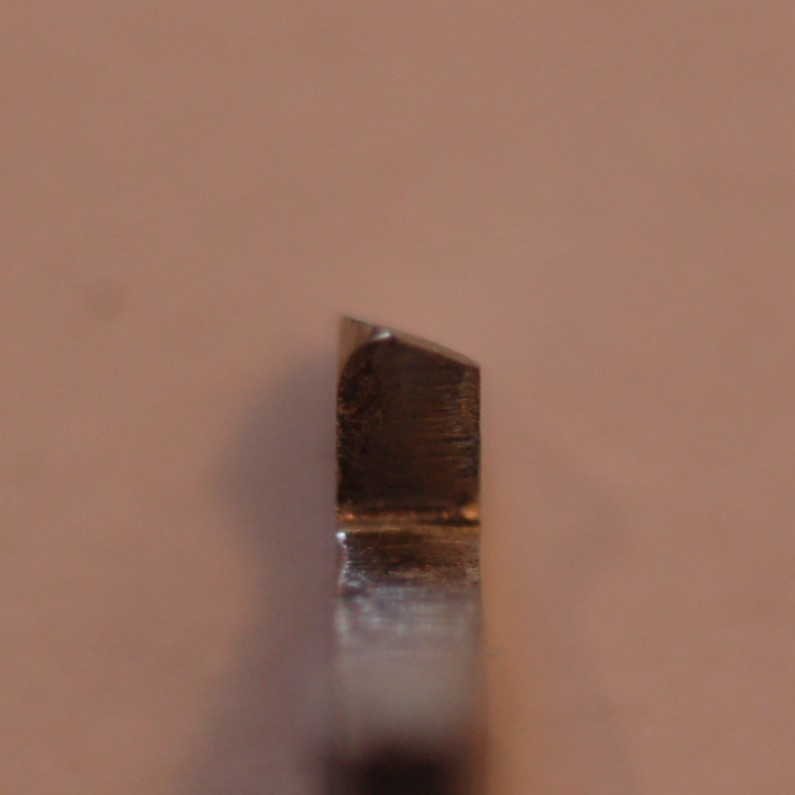

I'd hold off on desperate measures. It sounds like the "gap" on yours is better than most.
The first thing I would do is take a close look at exactly how the extractor holds a case in the bolt face. Because the Benelli extractor is at an angle, the nose has to be ground at an angle, otherwise it wants to push the round down off the bolt face. They also need a radius on the lower corner so that the extractor gets pushed aside as the case slides up the bolt face.
I've examined a dozen or so brand new extractors, and there is quite a bit of variation in how the nose is shaped. On some, the angle is almost non-existent, and others the radius is too large.
Rather than mess with uploading pictures someplace I can link to, I popped them into a PDF with some explanation. Hope this helps.

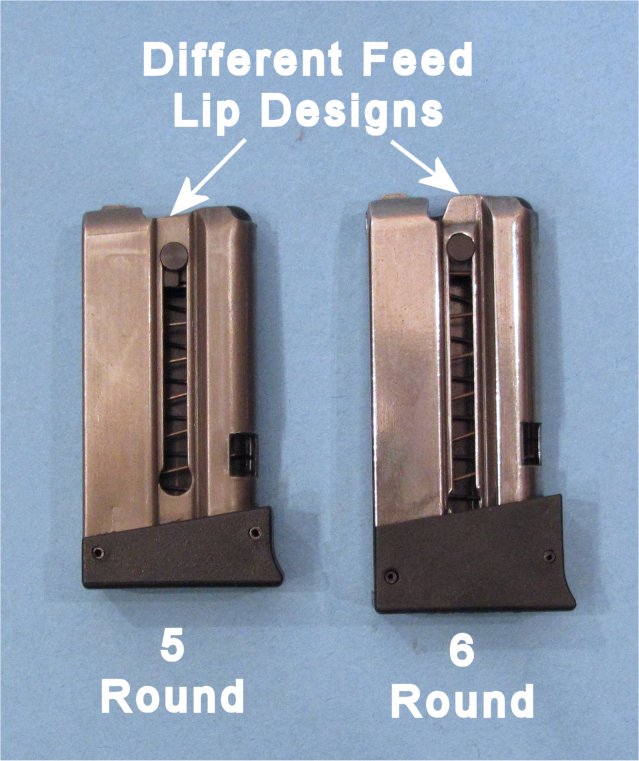

One thing I've never quite figured out is how the magazines get into the act. I know there is an interaction, because failures to extract are frequently "round-specific". For example, the most common time for an extraction failure is the first round, because that is when the upward force of the remaining rounds is maximum. That actually points to a slide drag/lubrication problem. The Pardini I'm working on always fails to eject on the 4th round, which is really weird... It's a good idea to mark your magazines, and keep track of which ones are involved when you have problems. It may be random, but maybe not.
When I first started working with the team, there were some pistols that would ONLY work with a specific magazine. We had about 20 spares which included a few notes about this one or that one not working in so-and-so's pistol. I took them all home one summer and rebuilt them. Unfortunately, I didn't think to test them in my Benelli first, so I'm not sure how many were actually "bad". In any event, by the time I was done, all 20 worked flawlessly in my pistol. Other than varying amounts of grime, I didn't find much that I would consider "wrong" with any of them. There were a few instances where the spring took a funny set, and in some cases, a loop would try to pop out of the magazine catch slot:
The springs don't have a well defined "top" or :"bottom", and often flipping them end for end will fix the way they compress inside the body. There can also be burrs in the slot the button rides in. New Pardini magazines are really awful in this regard, and manually cycling them up & down 20 times will usually smooth them up considerably.
I eventually found that the problem with the Benellis was usually with the pistols, and I've been trying hard to find and fix the subtle issues (like the extractor nose shapes), but some of them still prefer some magazines over others. Given that the "ejector" is part of the magazine, there's always a possibility something is amiss there.
I also had to deal with several different vintages of magazines, included both 5 & 6 round mags, which have dramatically different feed lip designs:
The one on the right is (I believe) the newer design, and the extra metal in the middle helps to guide the rim of the round up at the right time in the cycle.
I have found that some feeding issues are magazine related, but I also found that is usually still the pistol that is at fault. I had one where the firing pin tip broke, and the broken part raised a tiny burr on the slide face where the round slides up. That was enough to cause jams...
You say your slide cycles smoothly. Doing this with an empty pistol is often misleading. If you have some dummy rounds, try it with 4 rounds in the magazine, just to be sure. There are often machining marks on the rib the hammer rubs on, and the rim of the next round also slides there. A little smoothing there can help:
When all else fails, try a drop of thin oil on the top round of every magazine. I've never found this necessary, but the folks at Pardini USA swear by it.

So here's where I'm at, which is retaining the brass pretty tightly right now. Headed to the range to try things out.Gwhite wrote:Back to the topic at hand: I really don't think your "gap" is the issue. It sounds like a little careful tuning of the extractor nose will solve the problem.
I used your "Bad/So-So/Good" lineup from the pdf as a guide, and moved the "point" as far to the lower edge as possible without removing too awfully much material. It's at least around to 9:15 on the brass, and the sharper edge holds pretty well. A good rap on the bench still holds tight in the bolt. It never did that before.
I didn't have a small enough stone, but realized I had a diamond "Crystal Crafter" in the kitchen knife block. It's a half-round diamond file, maybe 1/4" diameter and perfect for lightly and precisely filing the compound angle, which I make out to be about 30 degrees from vertical and 95-100 degrees from horizontal. Tricky!
Thanks again for the encouragement (and extra mag info too).

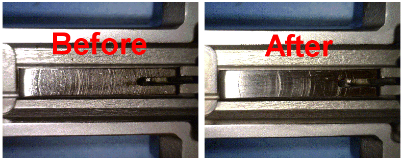

One suggestion for an update to your extractor info pdf: add a brief discussion of the "radius" at the underside of the nose. It seems so superfluous, but as you observed it's pretty important to the rising round. If the tiny rounded edge is rough, or small, the round catches on it. This in turn leads to jammed feeds since the round basically gets squished when it can't find its way onto the seat against the bolt. It squirts out the side, or forward, at the absolute worst moment.
I corrected the curve slightly on mine, and also polished it with some 1000- or 2000-grit paper, with good results.
The other observation is to be sure there is no flaking of the nickel plating at the sides of the extractor, which can interfere with it moving aside as the round starts to engage from below. In my case as I mentioned, I simply honed the failing plating off by sliding it flat across a stone.

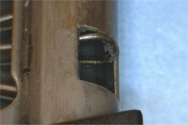

I documented the Benelli bolt I'm working on that appears to have a weak extractor spring. I'm ready to open it up, and I just received some new parts form Larry's Guns. It includes his re-designed extractor spring & push rods. I'm going to label them carefully, and compare them with a spare factory spring & pin I have from long ago when I bought my first Benelli. I'm hoping I can measure or see a difference so I can make sure we use the new ones in the future.

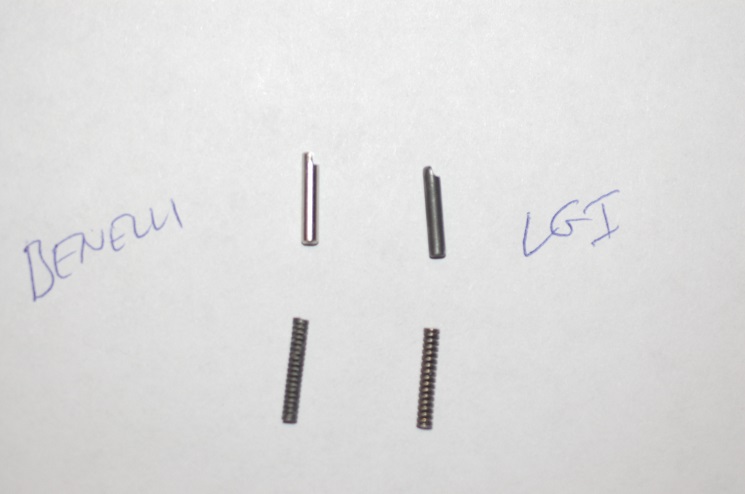

Re: Benelli MP90S extractor "gap"
Big differences, I mentioned these earlier and they work very well.Gwhite wrote:I just received some new parts form Larry's Guns. It includes his re-designed extractor spring & push rods. I'm going to label them carefully, and compare them with a spare factory spring & pin I have from long ago when I bought my first Benelli. I'm hoping I can measure or see a difference so I can make sure we use the new ones in the future.
The plunger has a radiused front edge that has much less friction on the extractor. The spring, while a little shorter once it takes a set as shown here, has thicker coils and is noticeably firmer.
Snapshot:

I just finished checking my extractor pin & spring collection. All of my factory pins are plated, where Larry's are black. I measured the springs and the wire in the factory ones is ~ 0.041 mm thick with 18 turns, where LGI's springs use 0.043 mm wire, with 15 turns. Both are about 14.5 mm long. I didn't see much difference in the radius on the ends of the two flavors of pins, but I can check them under a microscope later.
In any event, I took apart the misbehaving bolt. It had a factory spring in it, but (I think) more important was a flake of plating about 1/2 a millimeter square that could easily account for the sudden drop in functioning. I cleaned and lubed everything and reinstalled the extractor with an LGI spring. You can definitely feel that it takes a bit more force to get a round up into the extractor. I just hope that doesn't cause other issues.
Using the Lyman digital trigger gauge with a monofilament loop, the extractor force went from about 1 lb 12 ounces to 2 pounds 3 ounces. That's right up with the tension I measured on my two good Benelli bolts.
I also came up with a new dodge to make sure I'm pulling the extractor to the same point. I put a fired case under the extractor, and I read the force just when the case falls out.
With luck, the student who shoots this Benelli will be back this coming week and she can give it a thorough testing. In the meantime, I have a Pardini extractor to work on...
