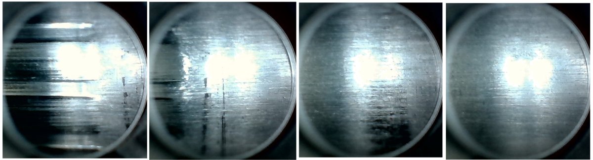

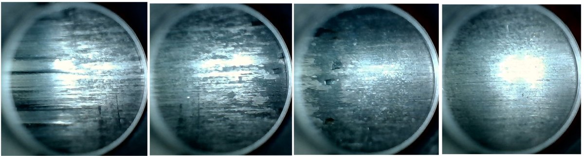

I took it home and looked at the chamber with my new borescope. Teslong now makes very nice ones for a tiny fraction of the cost of the high end ones (https://www.amazon.com/Teslong-Borescop ... B07TTQF24F). Here are a few photos after the Rem Oil session (photos go from left to right starting with the beginning of the rifling, and ending towards the rear of the chamber):
Near the front of the chamber, you can see a lot of black crud that appears to be flaking off. I gave it a VERY through cleaning using Bore Tech Rimfire Blend (also highly recommended), with extra attention to the chamber, using a tight fitting brush. Here's what it looks like afterward:

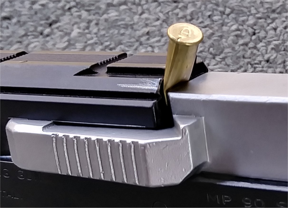

I've now fired two 80 round sessions of Aguila SV with one minor hiccup. The last round yesterday did an inverted stovepipe:
That's a VERY unusual jam for a Benelli, and may just be a fluke. I fired another 80 today (with no cleaning) without any issues. I'll try another 80 tomorrow.
It's certainly WAY more reliable than it has been lately. I suspect crud had built up that even a bronze .25 caliber chamber brush wouldn't completely remove, but the Rimfire Blend appears to do the trick. The chamber also seems a bit rough, and I may polish it at some point.
