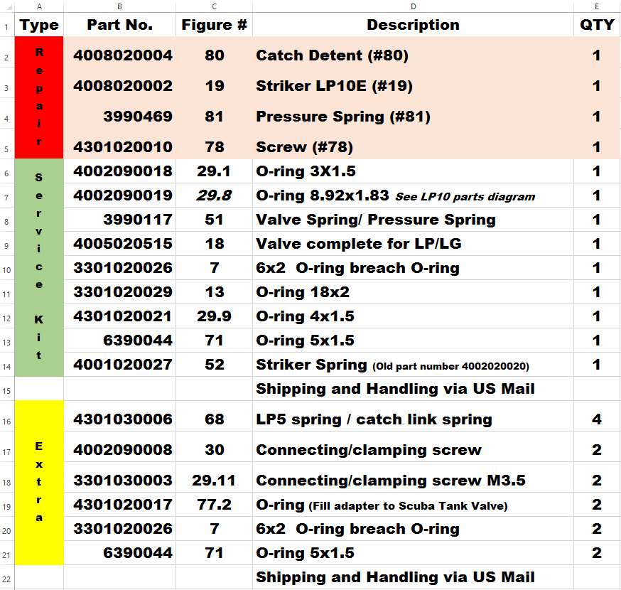

I ordered the parts in question from our forum host, Pilkguns, along with a "service kit" of parts.
***See attached image of parts lists ***
The red/pink are the repair parts. They were the culprit as near as I can tell--probably just worn out. All parts I reference are according to the parts Figure # in the mechanical drawings.
I'm glad I got screw #78, as the original got chewed up when I removed it. Figure parts #78 (screw) and #81 (spring) aren't really necessary, but since I was doing going to do a full service, I'm glad I got them replaced.
The green parts are what arrived as part of the "service kit" I asked for. Jennifer at Pilkguns was great to work with. It made the order really easy. When the parts arrived (each in their own plastic bag), I wrote down the mechanical drawing Figure # on each bag. This made it much easier to identify which parts go where. As a result, part 29.8 confused me a bit, as it isn't shown in the LP10E mechanical drawings, but IS shown in the LP10 drawings. It is inside the pressure regulator. I'm glad I had both sets of mechanical drawings from the Steyr website. Be very careful disassembling the pressure regulator as it is full of belleville spring washers--I used Figure #27(Grip Bar 40080200010) and slipped it into the bellville spring washer stack to keep the orientation and stacking order intact for later assembly. If you mess these up, just pack them up and send it all to PILKGUNS as regulators require special equipment to set up. I was especially extra careful to keep everything oriented the same way and in the same order.
Note the parts in the Yellow EXTRA section (my second parts order to our host-PILKGUNS). Despite my precautions, one of the Figure #68 springs disappeared when I took apart the recoil absorber. Neither I nor my eagle-eyed assistant saw this magic occur. So, I ordered 4 to replace all of those springs. Figure 29.11 and 30 are extra screws for the pressure regulator, as one of mine was buggered up from some previous work (of unknown origin-I bought the gone used), so I got a replacement and a spare. The other yellow parts are just some spare O-rings; the ones most exposed and likely to fail, but easily replaced.
Overall, the entire process took about 5 hours because I went very deliberately, and include the time reassembling the gun with the missing Figure #68 spring. I figure someone practiced could do it in under two hours (especially if they have parts on hand and aren't afraid to loose some). When I did install the Figure #68 springs (just remove rear sight and grip), I learned that you must install the rear sight screw back into the frame to reset the recoil absorber so you can properly adjust the recoil absorber spring per the video instructions.

The catch detent "Fangrast" (80) and striker "Schlagstückes" (19) are the parts I suspected may be involved from Chris' description.
Could be wear or damage so these parts are no longer engaging and would require replacement.
Also worth checking spring (81) which applies pressure to the catch detent, is in place and screw (78) which loads the spring has not loosened .

I would definitely preferred not to mess with the regulator, but, the service kit included a single o-ring that I could only find inside the regulator--and not being one to shy away from a challenge...I went for it--very,very deliberately. It wasn't too bad as I knew what to expect and took it apart very slowly to keep all the pieces intact, in sequence, and in the proper orientation (maintaining my own (and no one else's) scuba equipment 30+ years gave me a little bit of regulator background).
As for checking the velocity--we knew the Steyr LP10E felt and sounded hot....but 590+ feet per second (180+ meters per second) was a big surprise! 3 shots to confirm it was real and then back to work. It's back down to a much more appropriate 520 fps +/- 6 fps (10 shot string) now. I'm sure someone, somewhere has done to math to correlate velocity variation with potential point variation---but I'm happy with that result (given the statistically small sample to determine the observed velocity range).
I guess I should point out that what I thought was the trigger firing in the original post was really the striker being released after being cocked. Those parts must have been worn out enough not to allow them to work.
