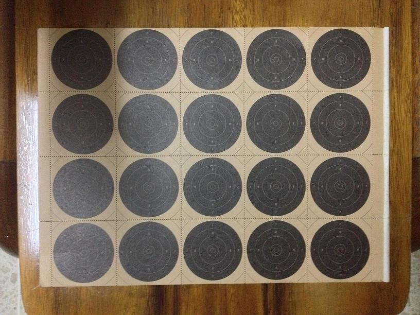

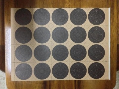

Did you see center bulls that are precut (like postage stamps) and are sold in bulk? The ones I am using have 1.000 center bulls. They only need to be ripped out, glued to the used targets, and they cut a clean hole when a wadcutter pellet hits the bull.
They sure save quite a bit of money and I don't have to dump a whole lot of targets in the garbage. I searched the internet, but have been unable to find these precut center bulls for 10 meter airpistol. I had purchased 10.000 of them from my extinct shooting club.

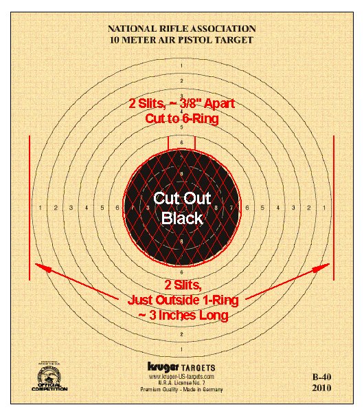

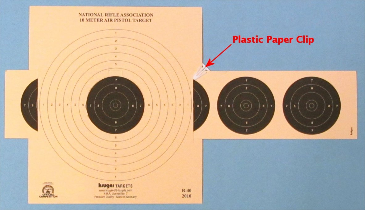

We used to be able to get the 5 bull strips from Edelmann through Pilkguns, but they were discontinued. I ended up ordering them directly from Kruger in Germany (No. 3015). 1000 strips is 38.15 Euros, which is ~ $42 US. That works out to less than a penny a center. We ordered 5000, but that was probably overkill, and made the box so heavy it burst in shipping. I wouldn't order more than 3000 at a time.
There is a print shop at MIT that has a super paper cutter, and they can cut thick stacks at once into individual centers for very little money. I think the most we might pay when the dust settles is about 2 cents a piece.
We don't bother with glue, we just slit the full sized target. Two diagonal slits out in the ~ 5 ring on opposite corners (~ 1:30 & 7:30, for example) can hold two corners of the centers. If you want to get fancy, you can even cut the target so you can use the full strips:

Thanks for the pics. The only problem I see with this setup is if the shots are strayed, they will affect the bulls on the left or right side.
Posts: 3566
Re: How do you use those training targets?
There are the occasional issues, but these are intended for shooters who can keep the vast majority of their shots in the black. For the beginners, we use cut up cheap 4 bull targets. The paper isn't as good & tends to tear, but the students are more concerned with grouping & learning the fundamentals than scores at that stage.
