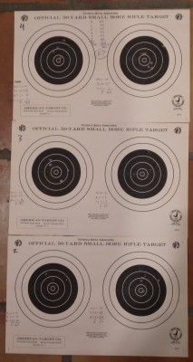

Last night was the first Standing at 40 yds with the FWB 10 meter rifle, 20x scope. It is quite tricky. Got a 260/300=87%
Trying for 50 yards now. What I am seeing is that after the hammer spring is adjusted/moved , it takes about 50 shots for the shots to settle in
and group well.
The fun part is when done correctly, crosshairs on the X, you can see the pellet go thru the X , crosshairs on X before , during, after. Trying for 50 yards now. What I am seeing is that after the hammer spring is adjusted/moved , it takes about 50 shots for the shots to settle in
and group well.
