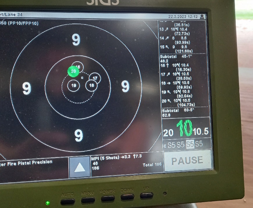

CFP is shot in Romania, at every national championship stage + finals (so around 5 times per year). there are around 4-6 shooters each time
https://youtu.be/_5NZX9cdL9Q
STP: Walther GSP 22
CFP: Walther GSP 32
STP: Walther GSP 22
CFP: Walther GSP 32
