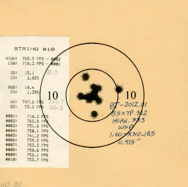

Factory Pardini barrel with Hornady 0.312" 85 grain XTP at 50 yards...
David

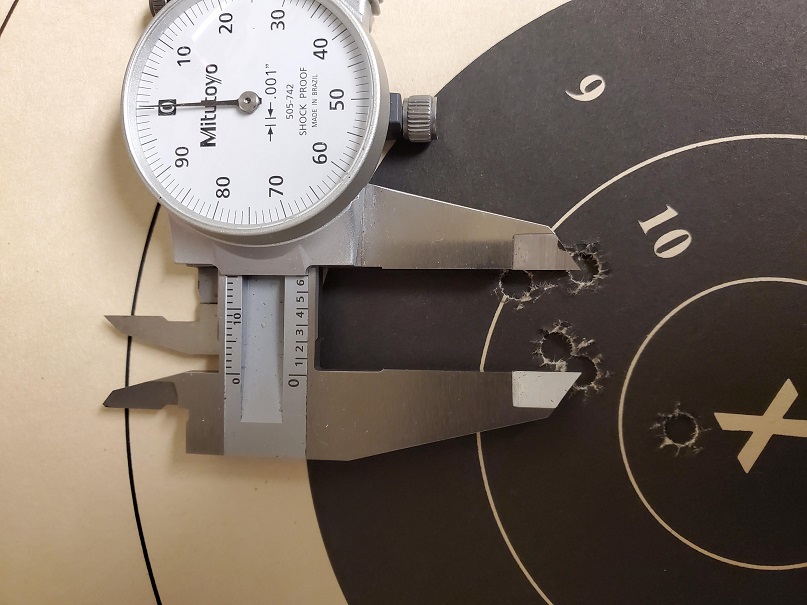

My concern was, is MY barrel in spec. I have seen good groups from a few other Pardini barrels. After what truly felt like a complete waste of a lot of time and ammo one group stood out from the rest. My options were to explore this combination further or start over with a barrel replacement. I decided to go to 5 shot groups to narrow down the best load for my barrel. Surprisingly enough it was very similar to what other were recommending. I spent a lot of time with the dial calipers insuring consistency. I still believe the only difference is all of the latest ammo was built on a RCBS Summit press instead of my XL650. This is by far the best I have seen from my barrel. All testing has been with a ransom rest and at 50yd.Image

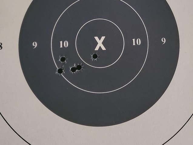

Post by ASchlem »
Same target. I just like this one more.Image
