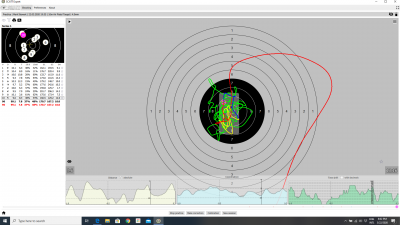

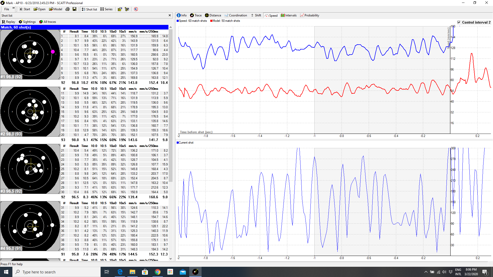

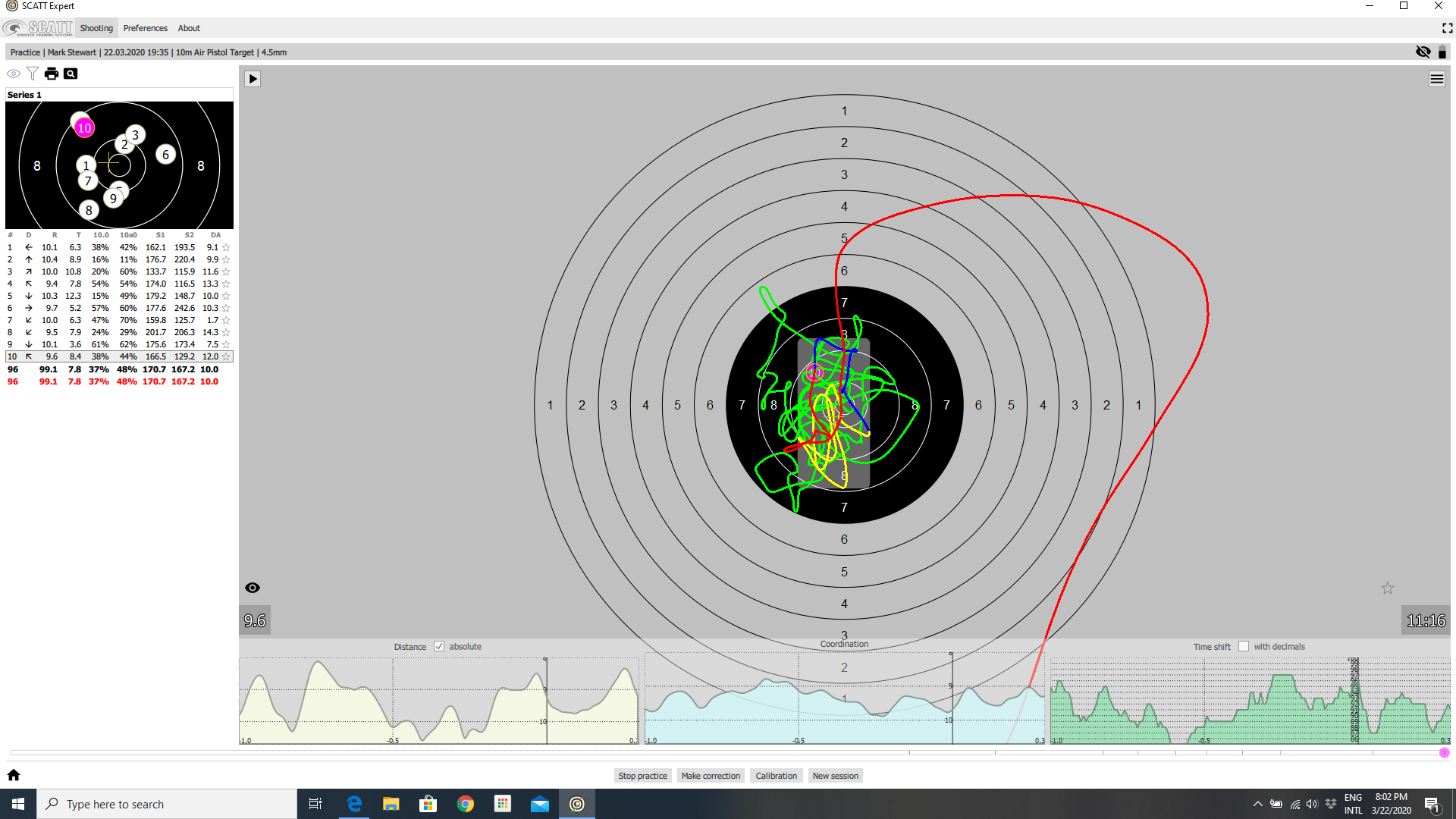

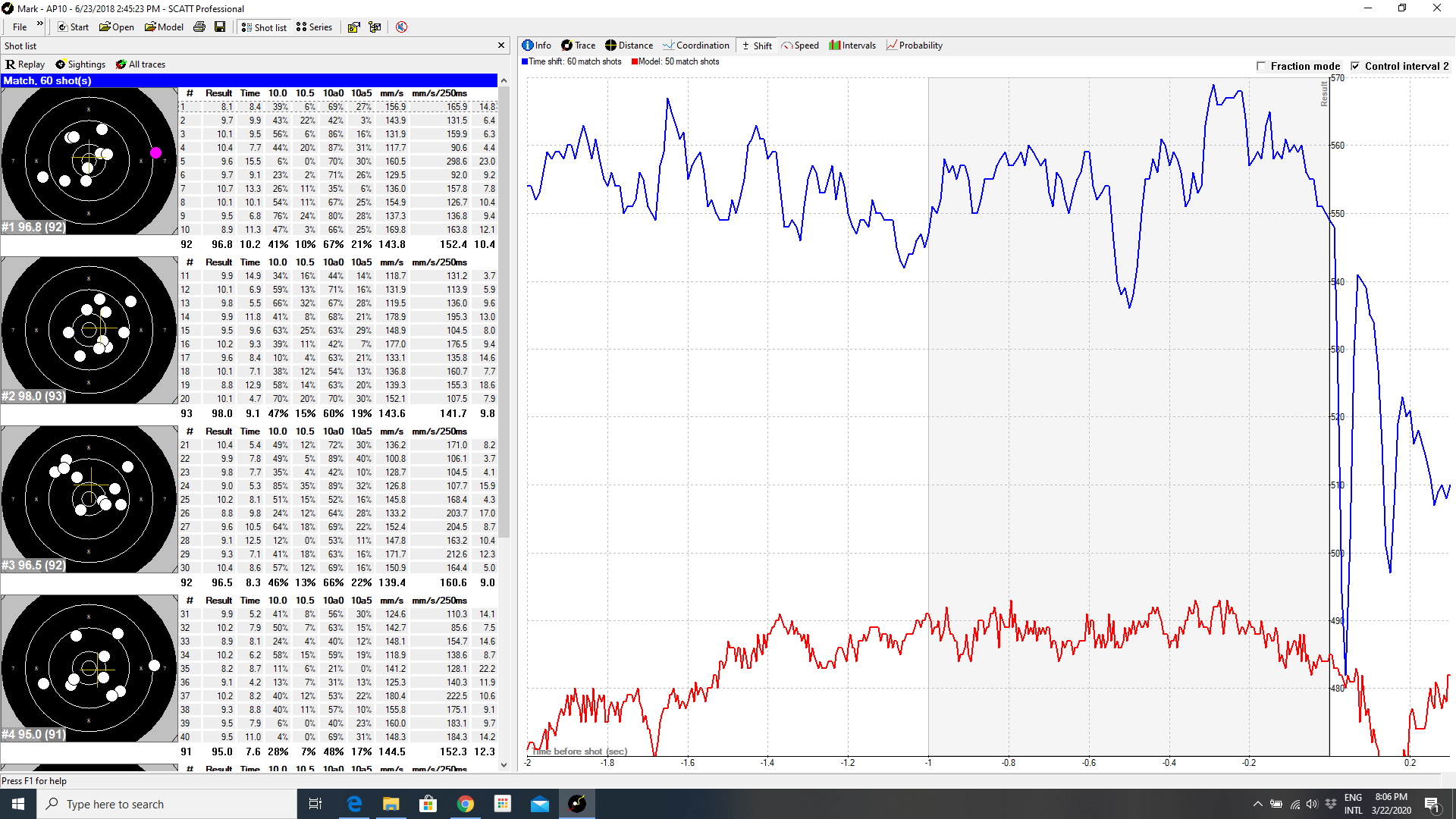

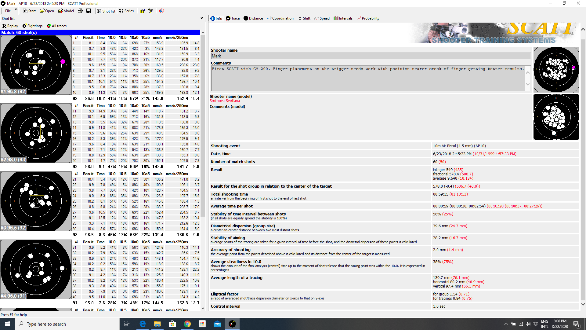

Is this how the top tier of Scatt software should be?
See how in the Pro , i could compare my results with that of someone good. Now the end of shot report is nowhere near as good as the previous.
The top picture is of the expert, the windows at the bottom of the screen are not really visable in any detail.
If you are thinking of upgrading , have a play with the software before parting with your money.
