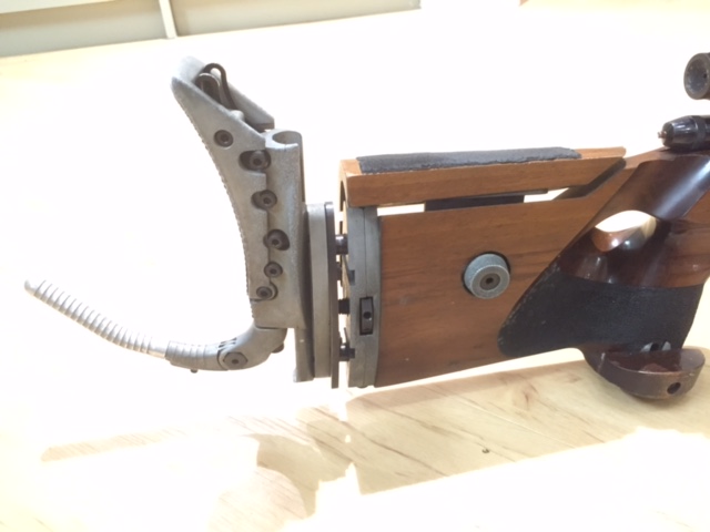

Came across this thread only today and just had to check my 2 Anschutz rifles I have. The one I shoot regularly (at least twice a week) is a 1981 vintage 'Super Match mod 1813' as clearly displayed on the barrel and butt hook that can only be swiveled sideways.
My second rifle is a 'Match 54', 1979 vintage, serial number ending in 'X'. Woodwork identical to the Super Match but with a more elaborate butt hook that can also swivel upwards. I'm guessing this is one of the intermediate experimental 1600 models?

Posts: 2028
Re: Pre 70's Anschutz barrel steel
Rob,
Yes the '79 vintage Match 54 is a 1600. These were introduced some time in 1976-'77, and replaced by the 1800 rifles in 1980. Compared to an older 1400 Match 54 the 1600 has a faster locktime, and a more sophisticated trigger. Anschutz lightened the firing pin and spring to make it faster, but also tried to stop it acting like a piston, and compressing air by milling a slot in the bolt. The slotted bolt was dropped for 1800 rifles, but these have an even lighter firing pin and spring, backed by a stronger secondary spring around the indicator pin.
That 1600 barrel might not be in the original stock if it's identical the 1813. 1613 stocks typically have a rounded triggerguard and slot-headed bedding bolts without the stacked washers found on 1800 rifles. The buttplate is a later 1813/1913 model introduced by '84.

Posts: 22
Joined: Mon Jul 30, 2012 9:01 pm
Location: England
Post by RobB »
Thanks Tim,
Looks like I have a 1813 stock with 1600 barreled action then. Bedding bolts are not slot headed, in fact same as the 1813.
You are correct in that the bolt does have a slot as compared to my 1813 which does not.
