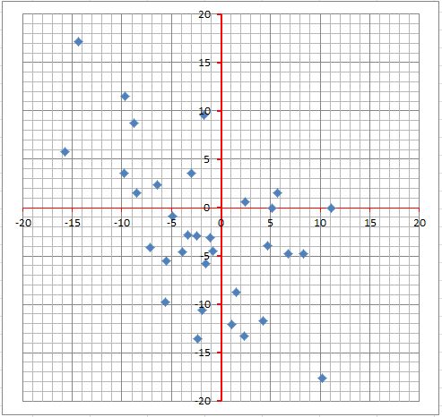

Anyone care to comment on my trigger errors (plot is distance from initiation point). Really interested in those with a value in any direction >10 at this point.
Cheers
David
I would be interested in any comments regarding my Trigger Errors

I quote from a training document I use re elliptical factor
"This attempts to portray a ratio of movement between the mean point of aim in the final second for each shot and the point at which the shot is predicted to fall. It does this in both X and Y planes. We are ideally looking for two numbers that are below 1.0 and as similar as possible. Numbers significantly larger than 1.0 can suggest a generally poor hold. Numbers that are different by more than a ratio of 2 to 1 indicate a likely problem with triggering."
So yours looks quite good.
