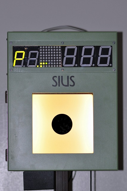

There's fundamentally two types of electronic target.
Acoustics use microphones to determine the position of the shot - standard Suis, Megalink, etc.
This requires a sacrificial strip (usually rubber) because for .22lr (subsonic) and air pellets, the mics hear the projectile hitting the strip, not the passage of the bullet or pellet. The strip is essential to the operation of the unit.
Laser systems such as Meyton or Suis Laserscore and Hybridscore use a light grid to detect the passing bullet/pellet.
Rio will be the first Olympics to use such a system and they have no "functional consumables" (apart from electricity!), although for the Olympics they will of course have the optional paper proof strips fitted.
In the case of either acoustic or laser shooting, paper strips can be used to prove the calibration of the unit if a shot is contested, but it is not technically required for the operation of the unit - merely as a backup for competition juries. Not every model would neccesarily have them - it's something you would consider if you were using them for an event of sufficient calibre to justify them.

Post by Huey-pilot »
I have been using my Sius Hybridscore for about 2 months in my home range and I love it. The price was $1995 and I had to provide my own computer for the display. It's still not compatable with Windows 8 at this time.

We have been shooting on the SIUS HS-10 Hybridscore since May. We choose this device over the Megalink because of the cost of the paper rolls. Also, we chose this device over the Elite scorer due to the fact that, in the US, the Elite Scorer had a temporary lower price for rifle shooters but not for pistol shooters, and it does require feeding: paper rolls.
With the SIUS there are no paper rolls to deal with/purchase for volume shooting. However, they can easily be added as needed, for scoring records. From a cost standpoint, the SIUS Hybridsocre is a great value when compared to the available options. The SIUS HS-10 Hybridsocre 'lights up' nicely in a dark basement, as well.

I was curious about hybridscore as it doesn't use a rubber roll.
Am I right in thinking the lasers cover the black, so if you're shooting in the black, they pick up those shots, and that the acoustic sensors detect shots on the white mask, on the basis if you're shooting into the white it's probably an odd bad shot and two probably won't go in the same place (through the same hole), so it's okay to have a static sheet, unlike in the black where you are expecting lots of shots to go in the same area and you needed a moving rubber strip to constantly present fresh rubber to the shooter.
