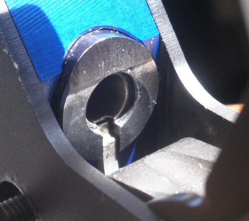

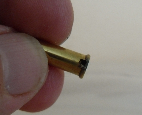

Pictures (regarding case rupture and extractor location) attached.
Freepistol
Posts: 773
Location: Berwick, PA
Post by Freepistol »
Gosh, Tom, your barrel looks defective to me. I don't think that slot should go in that far.

Tom,
I agree with Ben (I believe it is Ben) in addition to what I emailed you. The notch that appears behind your extractor is much deeper than mine is and as I mentioned my ejector is almost flush with the end of the barrel and the case rim of the barrel. There is no empty space behind my ejector toward the front of the barrel.

Post by RandomShotz »
That gap might explain the case rupture - there is no support at that part of the chamber and the rupture looks to be about the size and shape of the gap. When the ruptured case was extracted, did the rupture line up with the gap in the barrel? If so, I think you have a pretty good case for a factory warranty repair.

Post by TomAmlie »
Roger - that's exactly where the ruptures/bulges are; directly opposite the firing pin which is at the top of the bolt. I've only had a few ruptures (mostly because I quit shooting it after the first rupture except to test it), but every single case has an ominous bulge at the extractor location. Eley, with its thicker or stiffer brass, doesn't bulge as much, but it's still not a reassuring sight. Every single SK, Wolf, or Federal empty case is on the verge of failure.

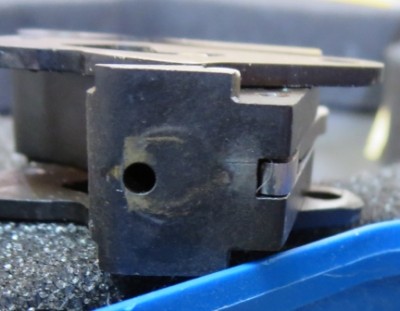

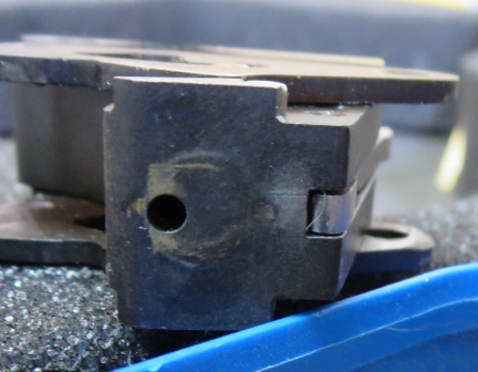

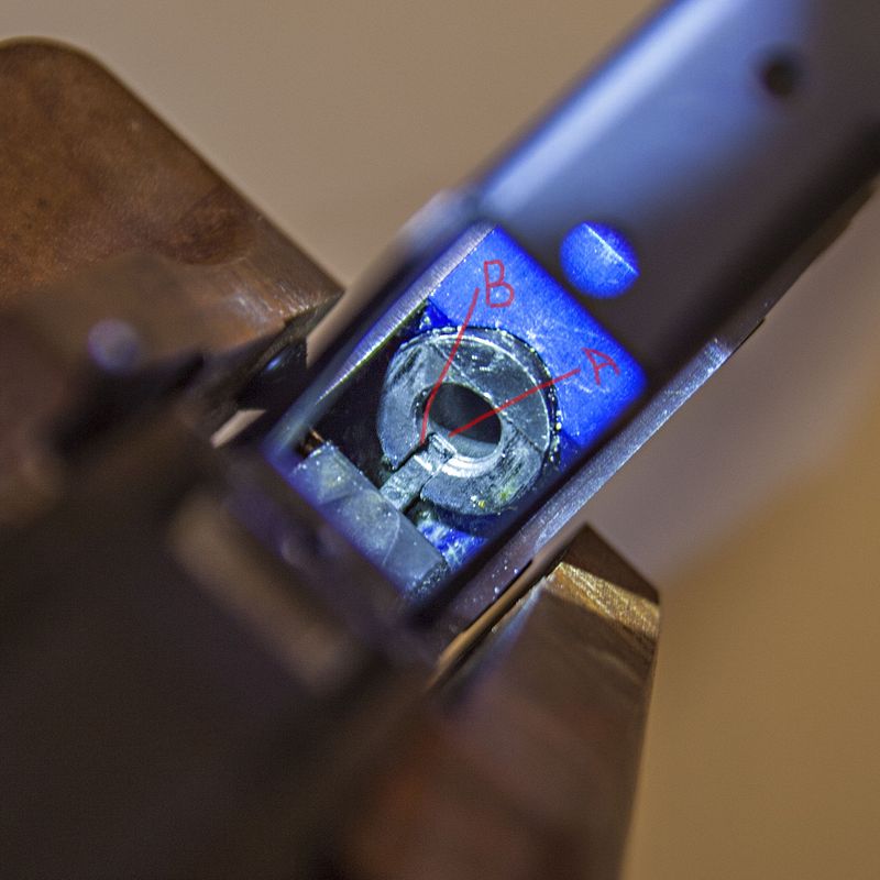

Can you show a pic of the bolt face?
TomAmlie
Posts: 357
Location: Mt. Joy, PA
Post by TomAmlie »
Hi James -
The bolt face is simply a flat area with a hole for the firing pin.

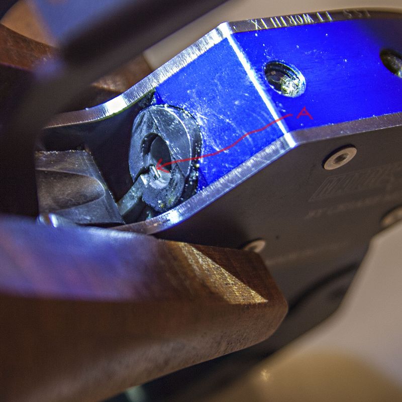

Post by northpaw »
I investigated this some, last night. From your photo it appears the cutout for the extractor at the rear end of the chamber of your gun is a bit deeper than that of my gun.
Regarding "tight" chamber: I chambered, and then extracted, several unfired cartridges of different brands.
For some brands, the front "shoulder" of the bullet (front of sylindrical part of bullet) showed "bright" lead, from bullet being squized some by the forcing cone, in front of the chamber. At chambering the round twice, it entered chanber with ease. So, the chamber itself may not be extremely tight, but the forcing cone/lead may be on the short side.

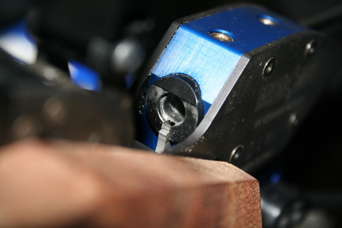

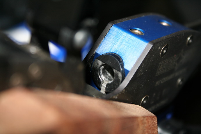

Post by ghostrip »

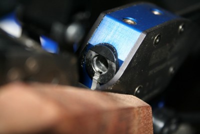

my guess from my mg5 inspection is that in tom's mg5 the recess for the extractor goes too much in to the chamber leavening an area of the case unsupported. i am not a gunsmith but seems he may need a new barrel.
